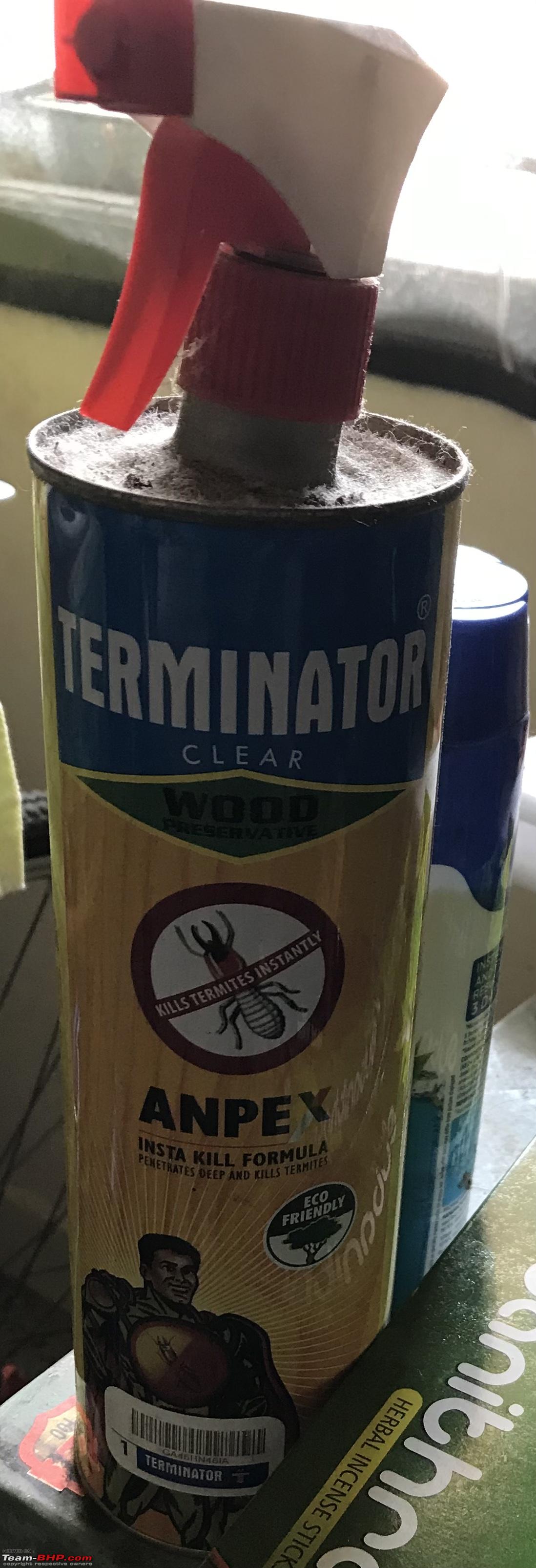

This does not look like the work of termites. More like some flying insect. Termites usually eat wood and form a soil / mud cover over the wood.
Here is the result of a termite invasion in our home. The house was not occupied for an year due to the lock down and this is the result.
Attachment 2217785
Attachment 2217786
We used above spray to stop them from spreading.
Please check for Bayer "Premise" (flipkart and amazon have this)that is used by the professional pest spray experts.
This is odorless and not allergic as the Terminator. Results are good.
I have used both and I feel - Terminator to be less effective on termites and more dangerous for humans. Causing me eye burn and much irritation.

I bought Beyers premise, mixed with water, and sprayed on the frames last weekend (I wore mask, safety googles, and gloves).
Update:
Looks like it worked. No sign of termites now.
