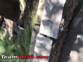

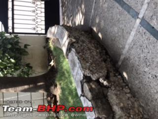

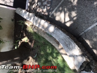

Hello team, I have a mango tree in my lawn. It is very close to the retaining wall of the lawn. Now the retaining wall has started to crack, which I think is due to the tree roots. I am posting a few pics of the same to get a better idea. Any suggestions to repair the damage and also preventions so that it does not occur again after repairing. Obviously I don’t want to cut the tree
The tree will keep spreading its roots and damage the walls near it. If you want to save the wall you have to cut the tree down.
If you want the tree and the wall, replace the masonry wall with a steel fence. A sturdy fence made of galvanised angle irons and a heavy dutu galvanised steel mesh will be strong enough.
You can go for Gabion retaining wall using same stones in Gabion wall there is no mortar and in steel mesh structure stones are filled to give weight.
Roots of tree will come from the gaps between stones and you can trim them also since there is no mortar stones can be readjusted.
You can also consider replacing the concrete wall with Segmental Retaining Wall (SRW) blocks. Just google for images.
Basically interlocking concrete blocks that dont need adhesion. If a portion of the wall is uprooted few years down the lane, you can remove some blocks, prune the roots, and rearrange the blocks. Definitely need to have some blocks on spare for maintenance.
