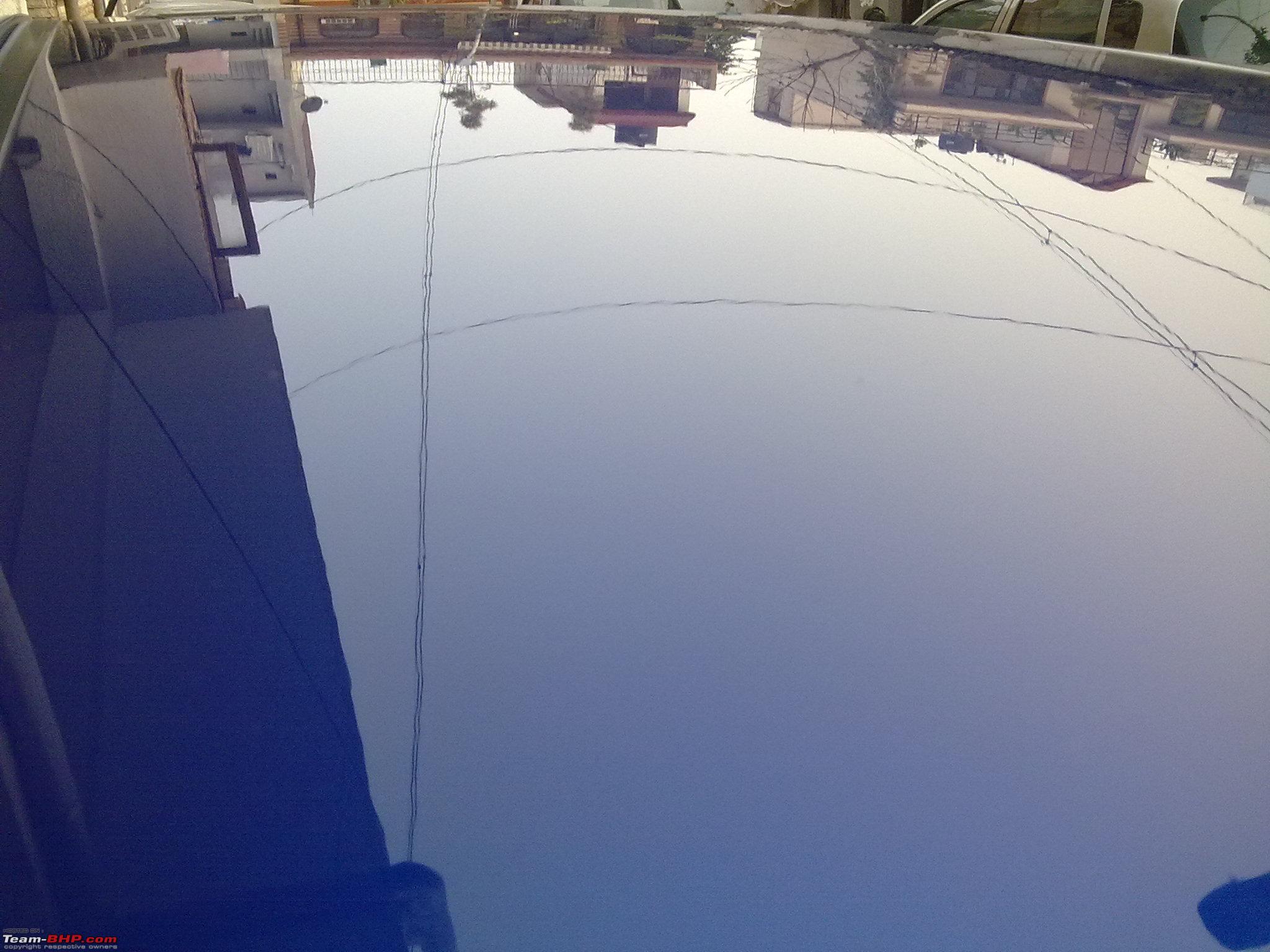

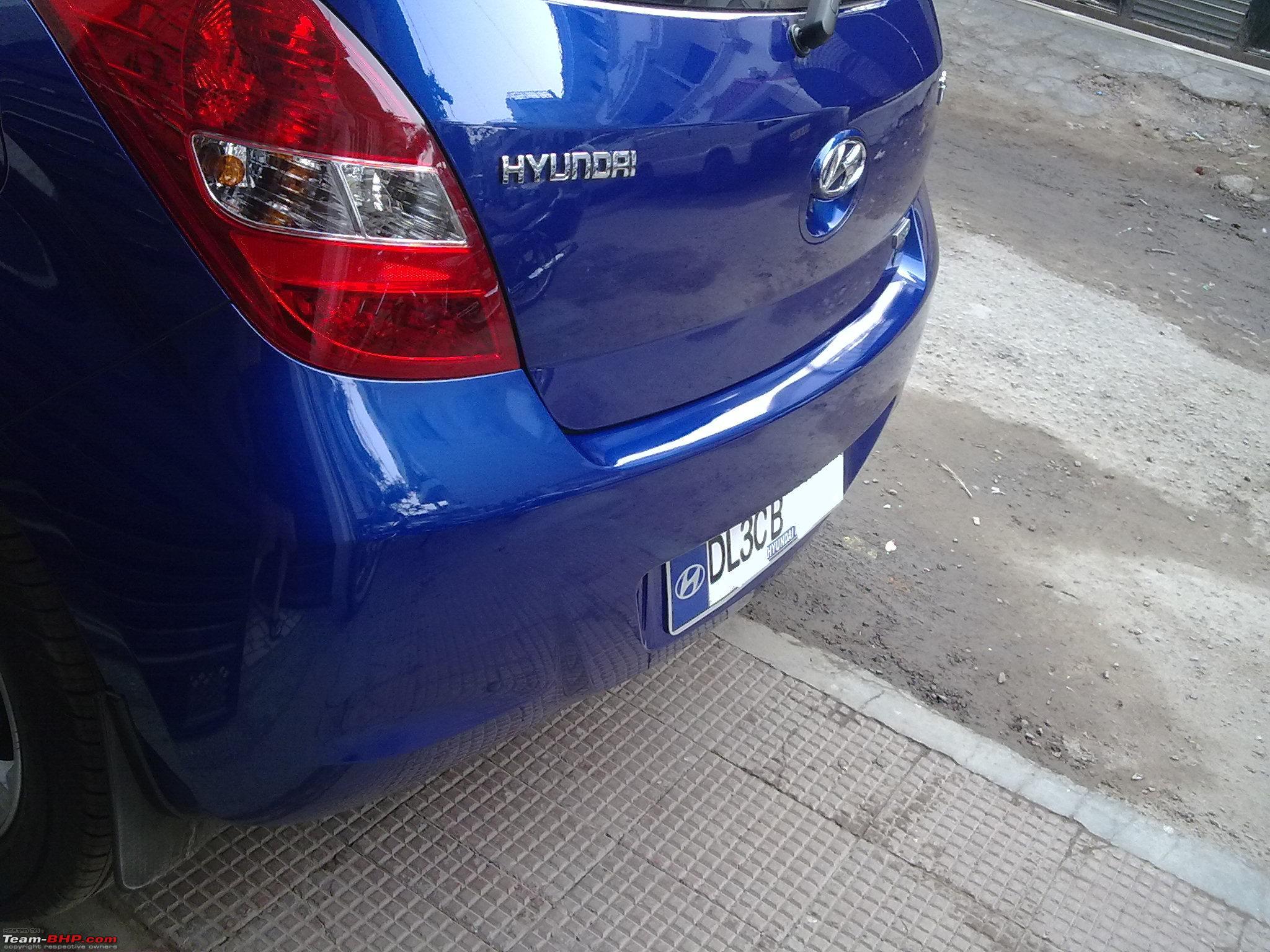

Hey guys!
Just pampered my i20 this morning!
I :-
- dusted off the car and then wet the surface to be treated with drinking water and used Meguiars clay kit to smoothen out the surface
- applied Highlighting Glaze and let it dry for some time and then removed with a mf cloth(boy it gives a great shine and wet look! )
- Topped it with Wax and buffing(meguiars gold class liquid wax)
- did a full body buffing with a clean mf towel
results were totally amazing!!!
now my i20 is looking much much better as compared to last week when I had washed and waxed it!!!
Glaze does give some really serious shine
Check out the after pics!

superb results- the glaze acts as a polish -which is one step in between what is recommended in the 5 step process. which product did you use- meguiars? Did not see any product in megs with that name..
One question about using clay kit- after u washed, did the surface feel rough to use the clay kit? I think only then should the clay kit be used or anyways it should be? Also can the clay bar be re-used? Am having a clay kit but dunno how to use it:(
How old is you car?
On a light note: be careful man- your car will surely attract attention with the super shine, don't want kids hovering around it esp since out in the open!

I used 'DuPont Highlighting Glaze' its a white colored bottle I got from a local dent repair guy
Claying
The surface was not exactly rough, but kinda waxy!(from the last waxing session I guess)
But since claying also strips off the old wax so it was kinda essential for what I had in mind!
I used 'drinking water mixed with car shampoo in a spray bottle' as a lubricant for the clay
just cleaned the surface and then sprayed on the above(lubricant) and held the clay in one hand such that it had stuck to my dry hand and then glided it along the surface(kinda like rubbing but with less pressure)

Originally Posted by sohail99 View Post
Hey guys!
Awsome, Awsome !!
How much time did it take for each activity - Claying, Gaze, waxing & buffing ?
Where did you get following from?
- Meguiars clay kit
- meguiars gold class liquid wax

I :-
Your car looks truly beautiful!
Just my 2 cents. Always thoroughly wash the car with a good car shampoo and get it as clean as possible before trying the claybar. And ideally claybar is always used with the detailer they give with it and not with water. If used improperly wax bar can cause surface marks on your paint.
