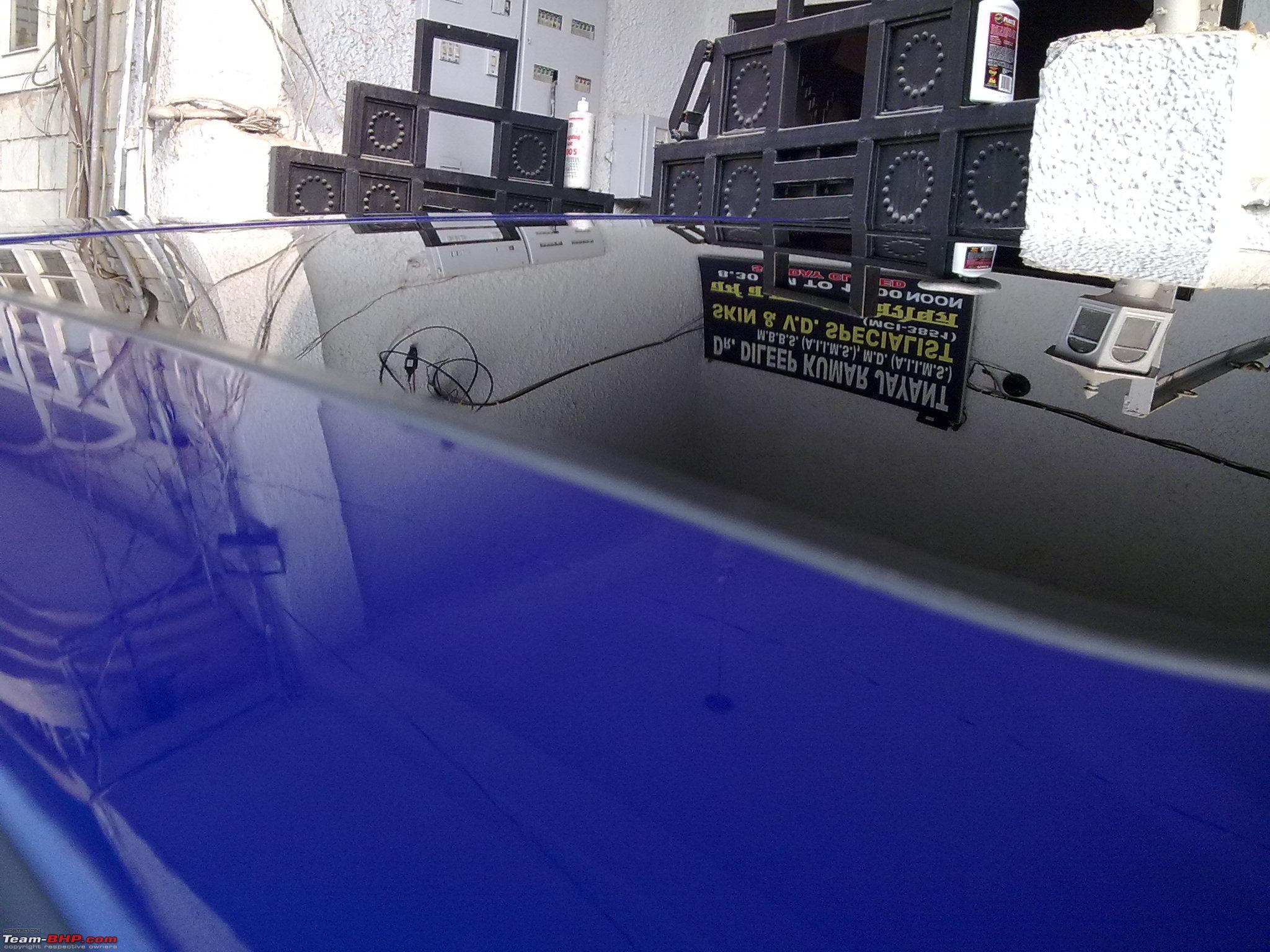

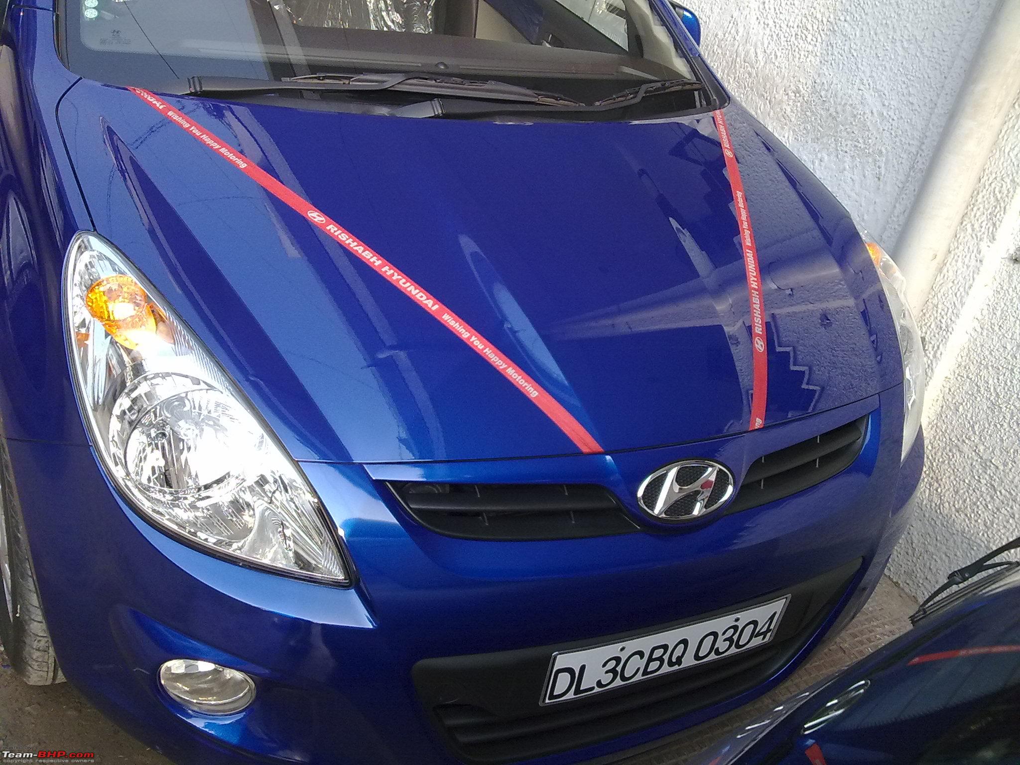

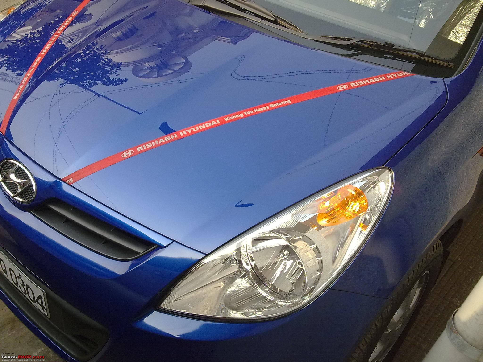

Just treated a few areas on my i20 with 'ScratchX 2' and then waxed with Meguiars Gold Class Liquid Wax
Results were amazing!!! its so smooth now!
I even saw leaf slipping on the paint!
Check out the 'after' pics

Great pics- suggestion: Remove the Ribbon, you will scratch the paint if you do not and if water falls, chance of some color coming off the ribbon onto the car.
Question: In my last post also i asked you about ScratchX- can you tell me for what kind of scratches did you use and how? I used it for different spots, it cleared some minor ones, but some more which i expected, wondering if i used it correctly
Yup! will remove it today only!
Regarding ScratchX, it seems to lessen the swirl marks to some extent and a few very minor scratches(ones limited to the clear coat)
and as it has micro-abrasives(safe for occasional use) it really brings out the shine!
I used it to remove a few scratches(very thin ones) that the car cleaner guy had caused when he tried to remove the dust with a totally dry cloth!
I :-
-apply the it on the affected part with the help of mf foam applicator pad
-depending on the no of swirls/scratches I keep it applying in a circular motion for a bit
-leave it on for a min and wipe off with a mf towel!
and the shine it gives is awesome!
-top off with wax
but for other more visible ones, I use 'Formula1 Scratch out' as its a mild rubbing compound!
