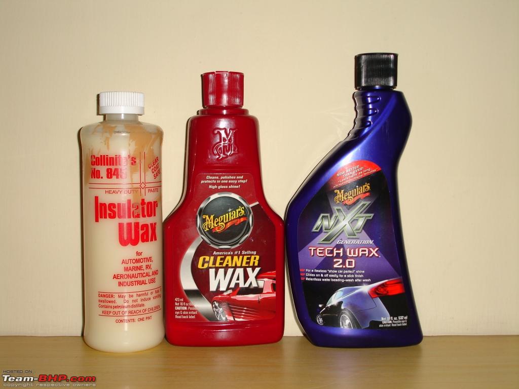

Thought of sharing pics of all the stuff gathered till now:
Soem desi stuff - excellent VFM
Still use the tire shine, glass cleaner and vinyl & leather polish
Wash
Clean
Paint correction and polish
Wax and seal!
Maintain
one for the road
MF towels galore!
The ones on the extreme right are Megs MF towels. Others picked up from Walmart.
