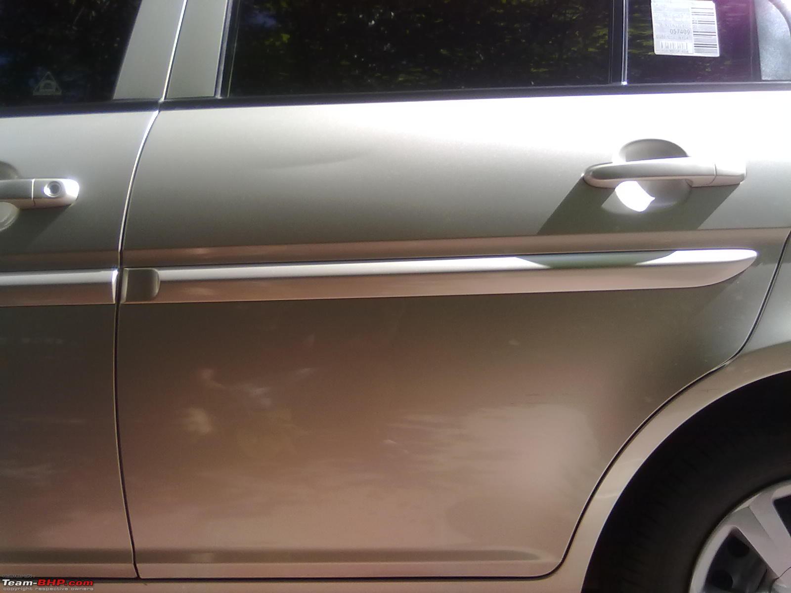

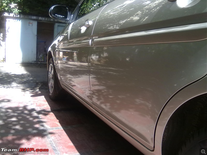

A quick wash and wax
So took blackasta's advice and went in for the quick wash and wax today morning. I realized quickly, that what he said was true - the 2 year gap had left a lot of work to be done on the car.
I found that the diesel job last weekend had to be done once again to get rid of the remaining 10 to 15% of black marks. I even found a few on the bonnet
Nevertheless, did my best to clean her up, wiped her dry with the quick absorb cloth, and got down to the waxing part.
Word of advice, keep a bottle of water with you if your going to indulge in such kind of activities in Chennai. In spite of it being 7 in the morning, the humidity really got to me after a while.
Applying the wax was a lot easier than the wiping off and buffing part. Used the microfiber cloth from 3m to do that. Took a long long time to satisfactorily get rid of all the wax. I remembered sohail99's post about getting rid of the swirl marks, and started to circle car again and again wiping off residual wax. I viewed the car from every angle, and made sure I had done a thorough job. When it was done had the windows and rubber parts cleaned by the watchman. In the meantime also took the other cleaning cloth from 3m and started giving another wipe down until I was satisfied.
For various reasons this was a far from perfect job -
1) Its my first time, still learning the proper techniques
2) The almost 2 year gap hasnt made it any easier
I picked up a small spray can of WD 40 from ritchie street for around 70 or 80 rs to use it the next time. I am also enquiring about the clay bar from jopasu.
While a lot of work still needs to be done on the car, I am fairly satisfied with todays outcome. Have attached a few snaps. Probably not as mirror like as some of the other cars here, but its a starting point.

^^^Great Results , car is looking awesome .
getting 3m clay in a week. any reviews on that ???
