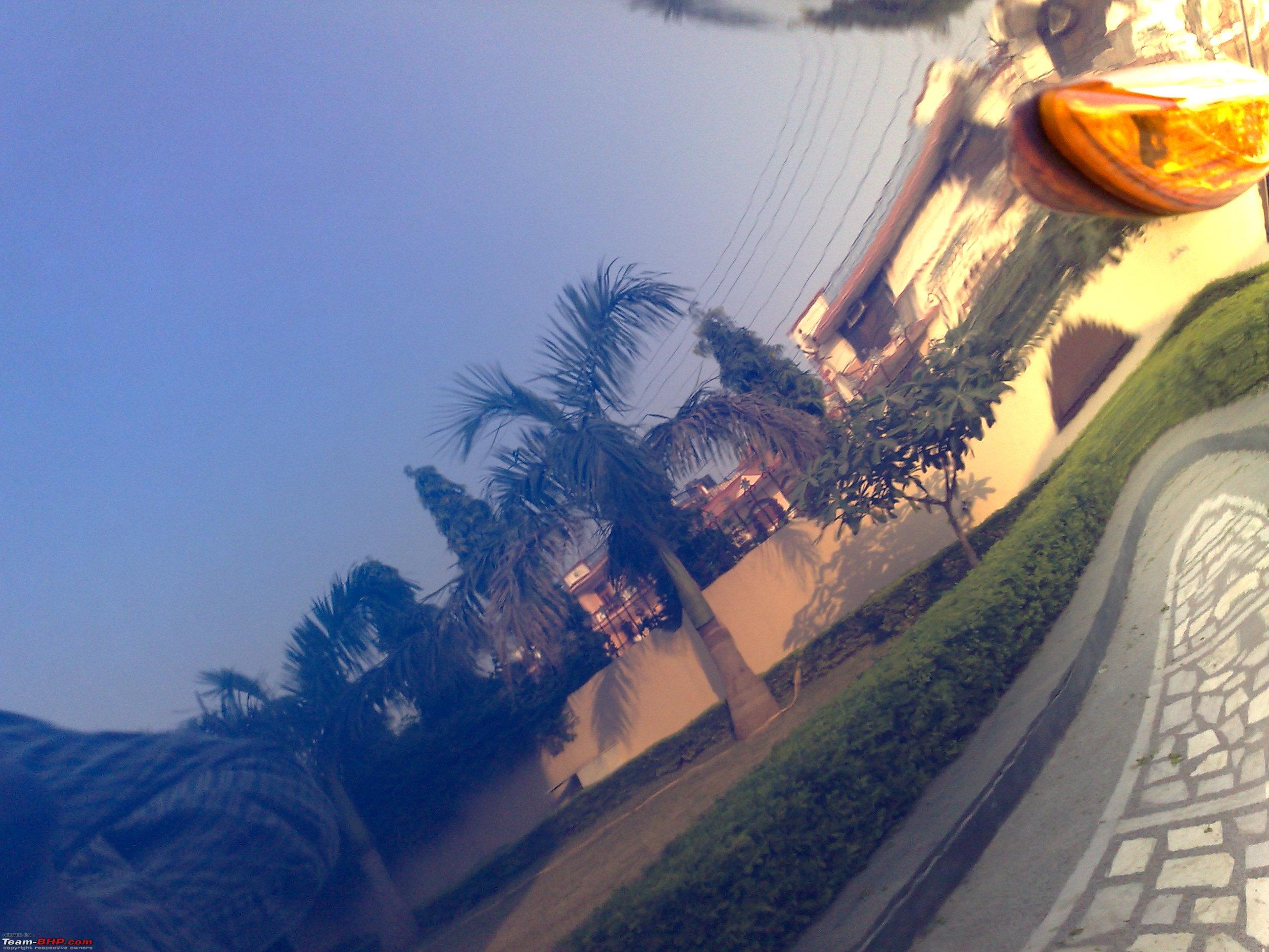

btw I got time yesterday to do the front of my i20.
Did finishing on the bonnet, front bumper and both front fenders
Bonnet came out awesome!!! The metallic flakes were so clear and at an angle you could see the iridescent paint effects! lol
Iridescent effect! lol (j/k)
Front fender(right side) had a few swirls
After
front bumper(after)
left fender(after)
A superb Car cleaning, polishing & detailing guide-fender-reflection-shot1.jpg
A superb Car cleaning, polishing & detailing guide-fender-reflection-shot3.jpg
NOTE - Sealant has not been applied yet!
I think winters are the best time to detail as, though the sun is out, it isnt that hot and also the panels dont become that hot and are easily workable! + you can see all the defects + remove them !
Thank you God for the natural swirl finder light!
