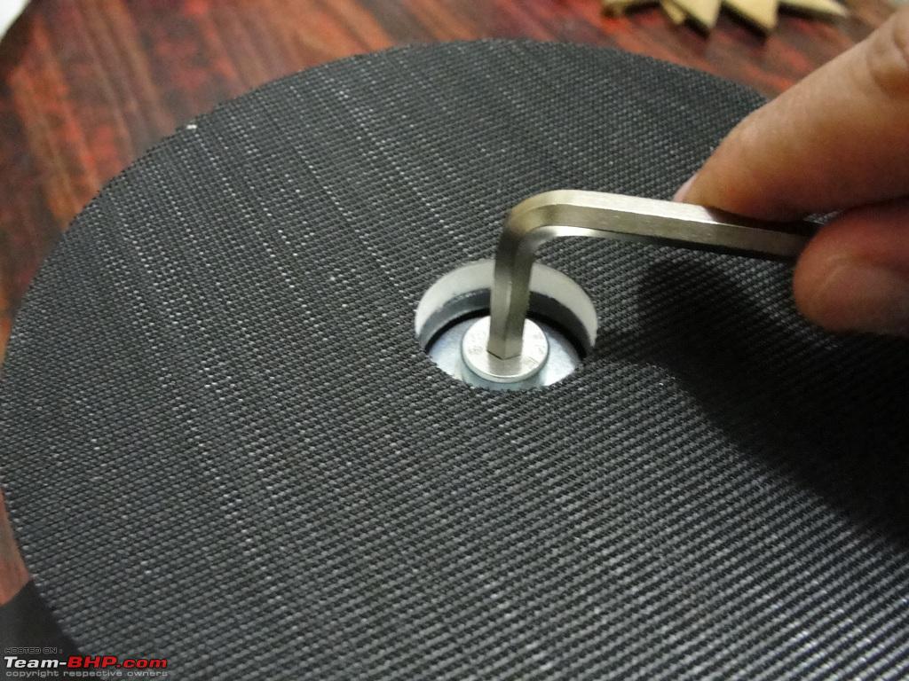

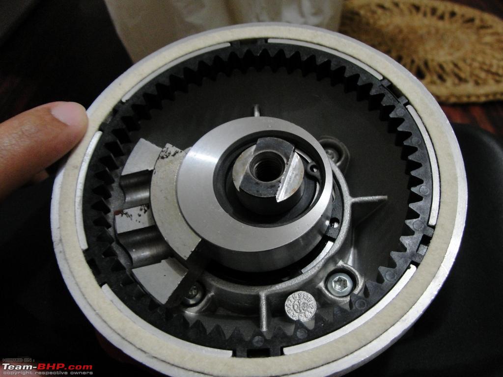

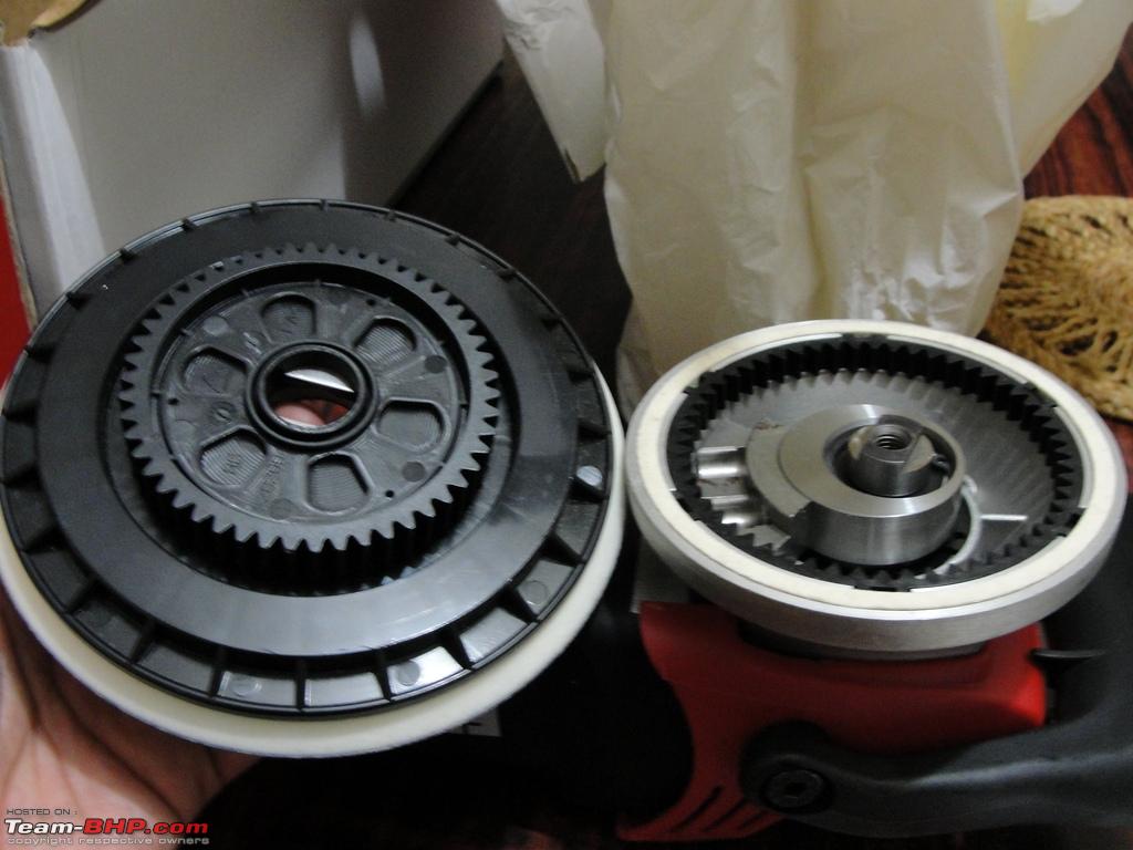

Before that, opened up the backing plate for oiling the felt ring as gurus suggested :
After oiling the felt ring :
Attached back the backing plate with the supplied allen key :

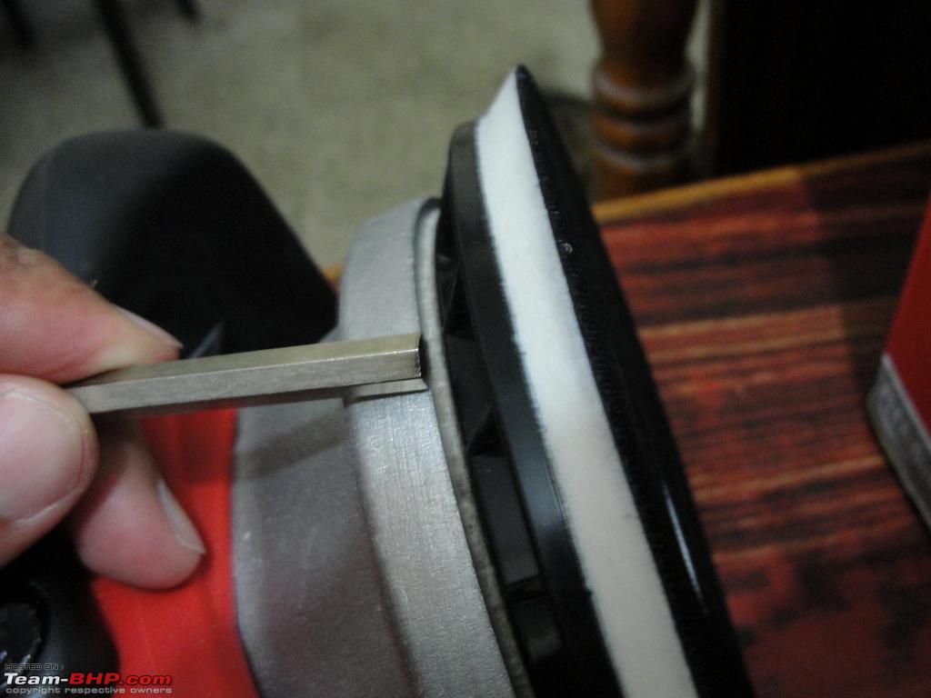

Could not understand the reason for oiling (manual does not say anything) but on closer inspection the ring seems to be in contact with the backing plate.
Marked the backing plate to check the rotation

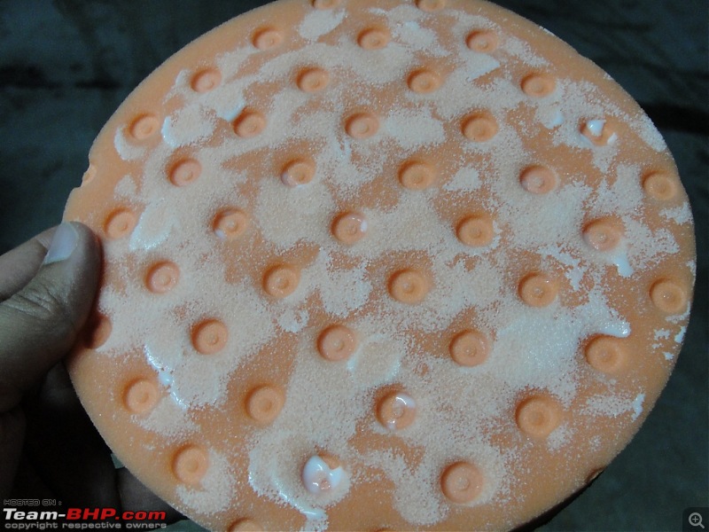

Priming the pads with Megs 205

  2. which ring exacty you oiled ???, sorry cant make out from pics.please mark a pic.
A) Im attaching a picture with the felt ring circled in red. The 3rd pic is after the oiling.

After using the orange pad, you can finish/jewel the paint with grey pad and M205 again at a lower speed for that extra 'pop'!!
Great you tried M205 first. In case of a repainted panel, you can also try M105 for quicker defect removal with just a few passes.
btw did the polish dust a lil' or no dusting at all? (M105 dusts like hell!!!!)

Did face a dusting problem, wasn't too much, kept spraying on some water from time to time to keep it wet. 205 is a great product to work with, stays wet longer !

Nos007 - Pic attached of the felt ring !
