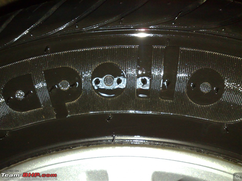

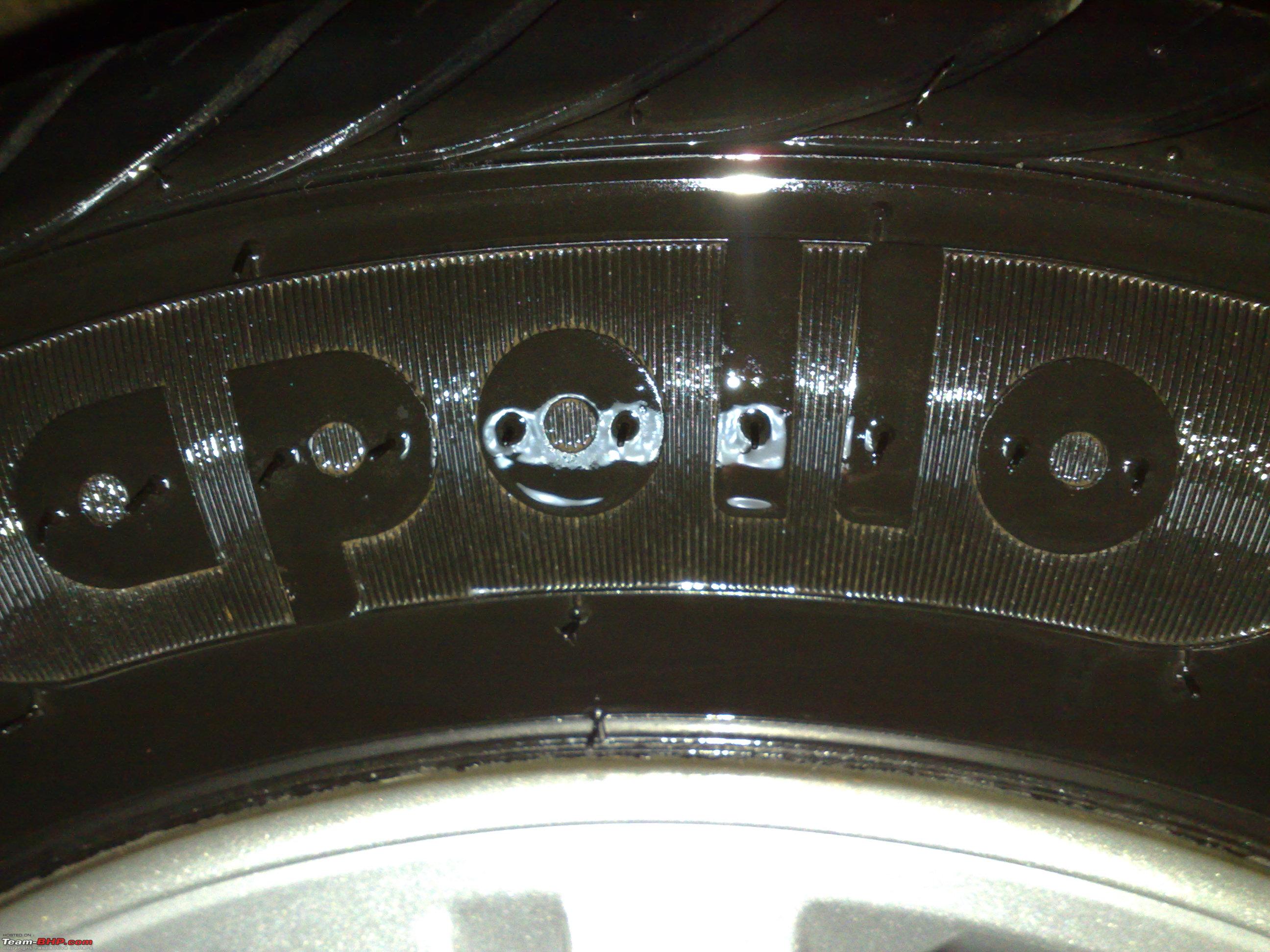

Oh! btw I was cleaning up my tyres today and I was literally shocked to see the finish on the tyre sidewalls after dressing them!!!
Now my alloy wheels look nothing compared to the tyres! lol!
Just check out the distinction of image!
Sohail,what tire dresser are you using?

Originally Posted by nirmaljusdoit View Post
Wow ! I never knew DOI was achievable on a tire sidewall ! Did you use any new tire shine ?!
Lol! yea! I too was surprised!
no new tire shine!! Just noticed its full potential now!
Locally available Turtle Wax wet n black! (its kinda like a gem in all the car care crap we have here!)
How did u manage such a deep shine with the turtle wax?

@sohail: Looks like you got clear coat on your tyres as well
