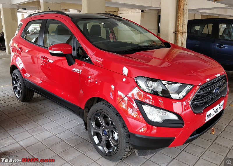

Spend my Sunday afternoon giving my car a good wash. Used Meguiars car shampoo and quick wax spray. The car has recently been detailed with opti coat hyper seal and hence was easy to clean. Used 3M dashboard dresser for the plastic cladding.
That gloss

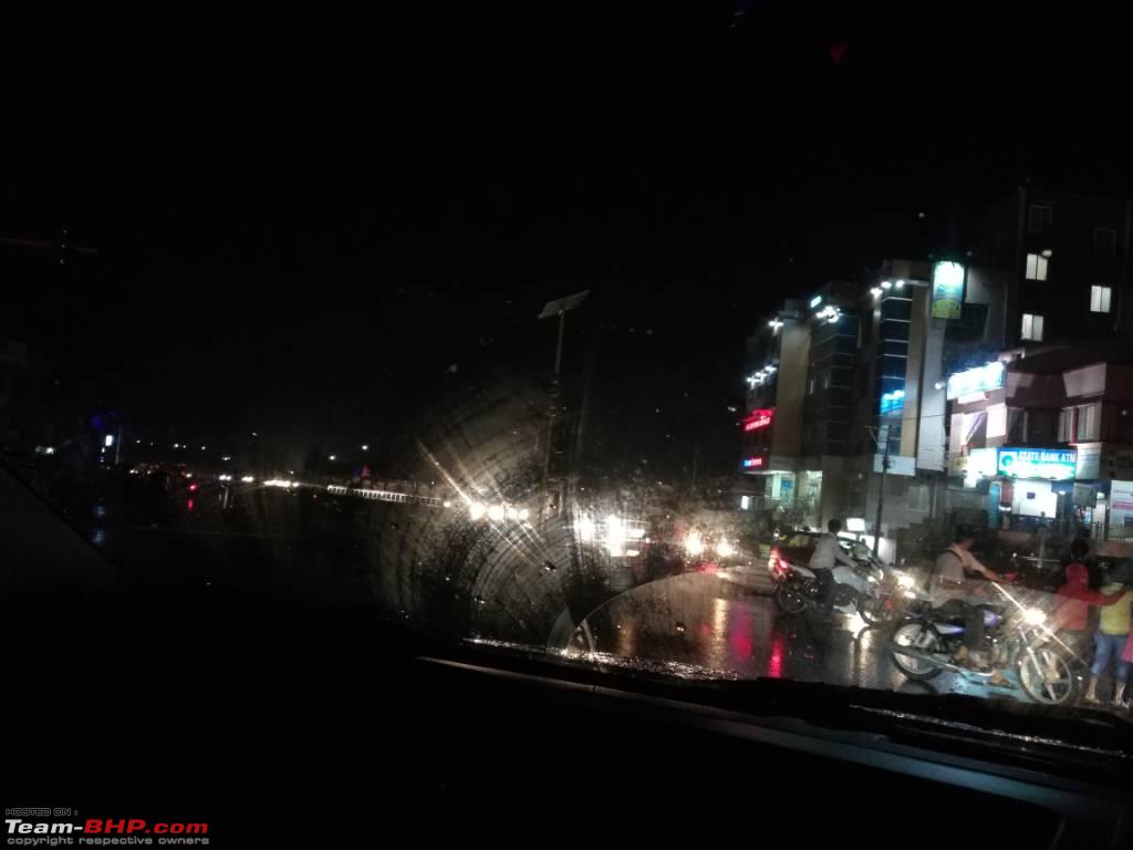

I have this wiper blade problem on my V-Cross. Any ways to fix it?
I have changed two wiper blades in the last 3-4 months. Currently using Bosch wiper blades.

The problem is with your windshield. Please get it cleaned professionally from people who know what they are doing. Should include a shampoo + road film removal + polishing (if required, and glass polishing is substantially different and uses completely different compounds and pads from body polishing) + hydrophobic coating done.

I suspect the windshield. Use a good clay bar and clay the windshield. You've switched too many wipers within a short span of time. Usually a set lasts a year before the next monsoon arrives.
Detailers can do it as well. Take it to a detailer and check.
I tried with claybar and it did not really help. Seemed to work initially and the same issue resurfaced.
Yes, planning to take the vehicle to Detailer.

Would suggest you try sonax cleaner before you take it to a professional. I had a similar problem but it wasnt as bad as your case. The sonax cleaner solved it for me and now a regular wipe with the same ensures windshield is perfect.
