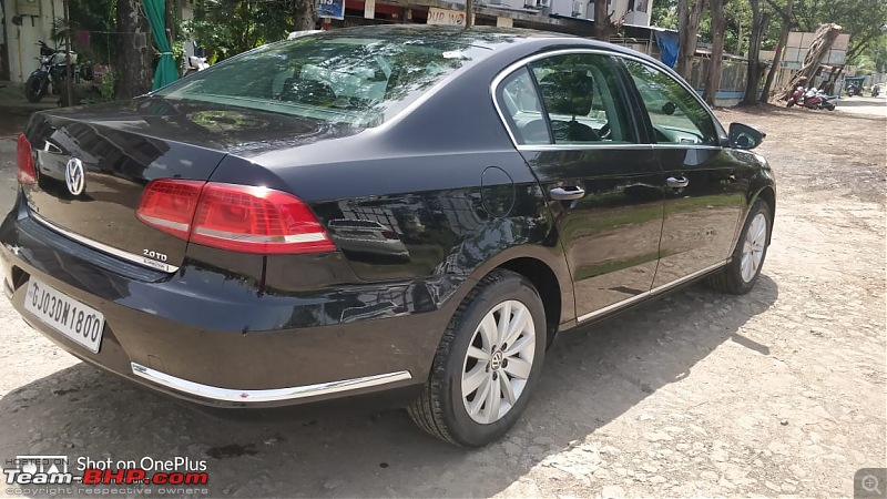

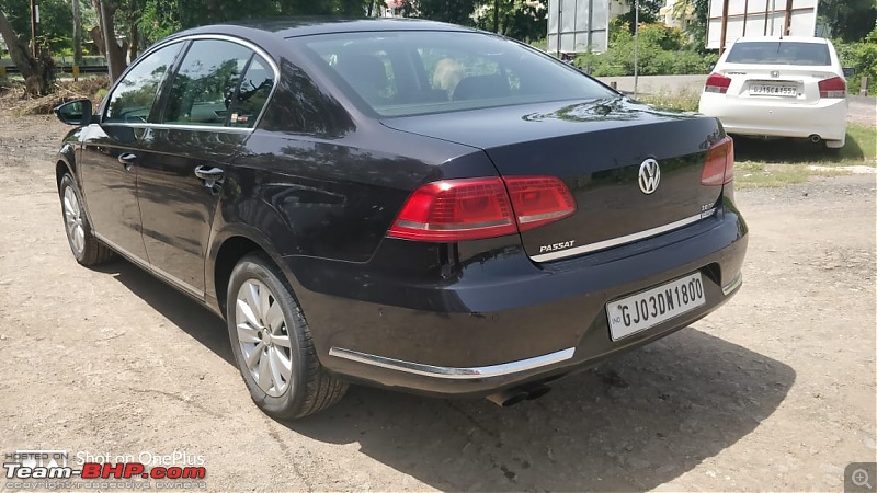

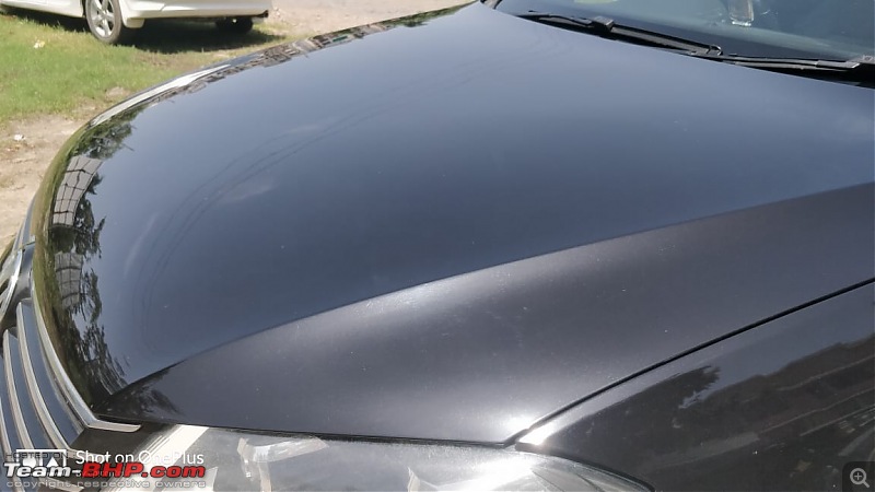

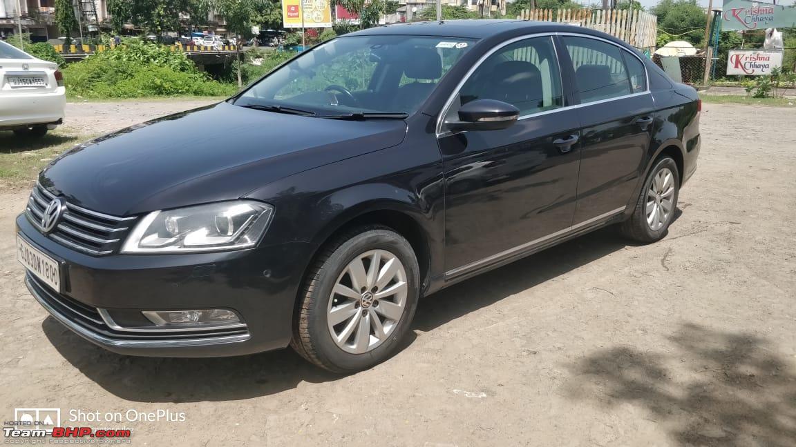

Hi Gaaij,
Here goes. Some photos of the DIY detailing done on the mighty Veedub.
It is a 2011 model HL DSG which I have used for around 221000 kilometers.
This is a combination of the infamous Chemical Guys complete range of optical grade compounds and finishng polishes plus one of the best ceramic coats available in India, the Sonax CC36.
Will put up the entire detail story later. Till then, enjoy the photos.
Drive safe, always wear a seatbelt

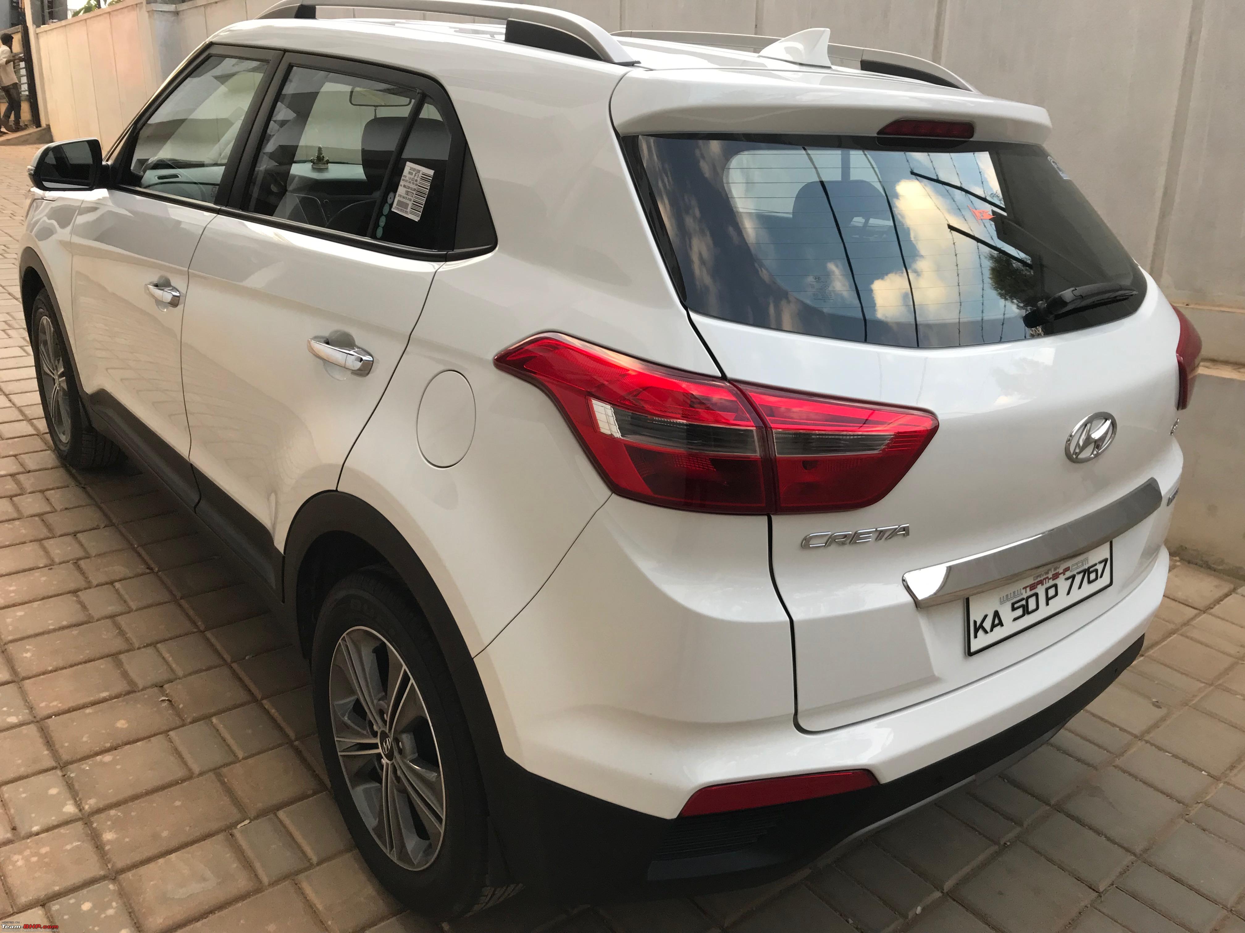

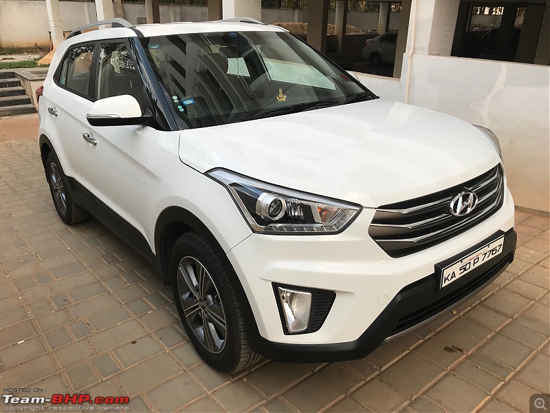

Before the summer arrives, decided to pamper my Creta this weekend. Did the following
1. Full wash including underbody at the local car wash
2. As my car was driven on a newly laid road near my house, there were tar spots that needed attention- Formula1 bug and tar remover did the job rather splendid!
3. One coat of Swirlx applied to remove those swirlys
4. After 24 hours of applying Swirlx, applied a coat of Collinite 845.
5. For the black cladding applied Chemical Guys VRP Protectant
6. Cleaned the seats with leather wipes and then finished with chemical guys leather protectant
7. Doors & dashboard prepped with a clean damp microfiber and finished with VRP.
8. Swirlx applied to the rims.
9. Formula1 glass cleaner applied to all the windows and windshields.
Enjoyed every bit of it and its totally worth the effort! I am planning to apply a second coat of Collinite next week so that it lasts the entire summer.
My second session of detailing happened yesterday. Followed the same steps, but this time i applied the Chemical Guys Insta wax+Sealant instead of collinite and I am very happy with the result. The car looks as if it just rolled off the assembly line

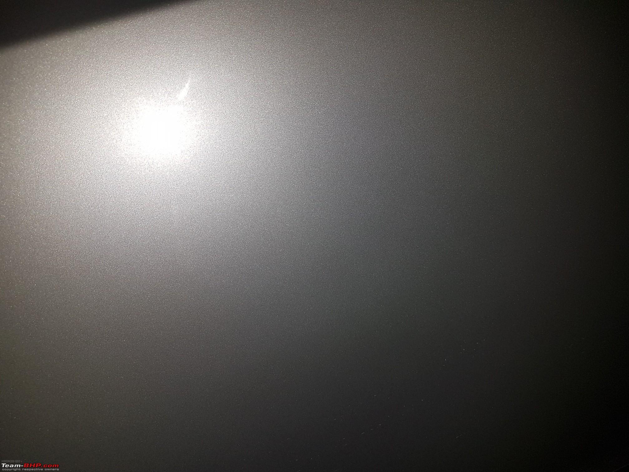

No wax can fix light scuffs. Either polish them out or get it touched up.
