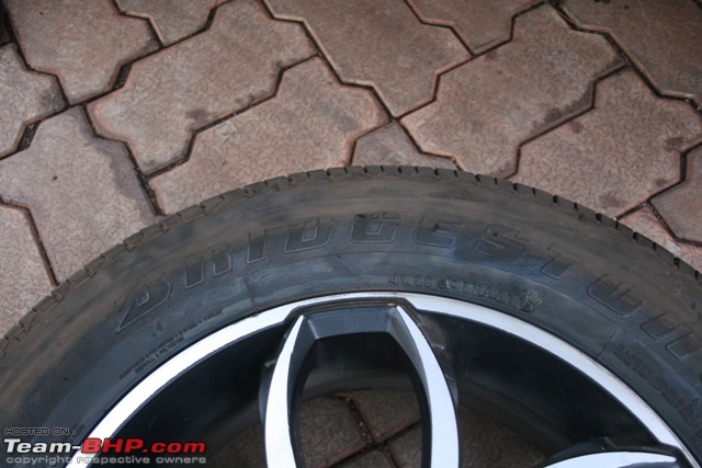

I am not sure how to put it, would it be considered as niggle or manufacturing defect. I certainly would attribute more to be as manufacturing defect or to bad workman ship of the person who did this. This happened on 3rd day after the delivery.
The metal part of valve completely came off, this happened after 400KM of travel. Luckily it happened towards just at the end of the Journey. This happened when I was travelling on a cement paved road which has rhythmic beat, so it took a while (around 1.5 to 2 KM) before I realized that something was wrong. Also this happened to left rear wheel that’s why I couldn’t feel that pull on the wheel.
Since I have used the official accessory and was done at the showroom, I am planning to take this issue with the RM and claim as warranty. As you could see that the side walls have been damaged considerable, I am expecting that this is not usable as spare wheel as well. Please advise me if I can claim this as part of warranty.
Also I guess the people should be very careful as the accessories people might have pulled the valve very hard hence it would have given up when the temperature was high due to summer. I have already informed the RM and she wants to inspect the tyre before she can decide whether the tyre can be replaced.
I will update once I take the vehicle to workshop on Tuesday.
I have already informed the RM and she wants to inspect the tyre before she can decide whether the tyre can be replaced. I will update once I take the vehicle to workshop on Tuesday.
You don't have TPMS ?
I doubt that the tyre manufacturer would replace it unless it is conclusively proved that the valve coming out was on account of a manufacturing defect, you may have to push M&M to cough out a new tyre.
Hi vrraju, This looks more like workmanship defect of the person who replaced the alloys with these. How many kms has the car done after the alloy swap?
