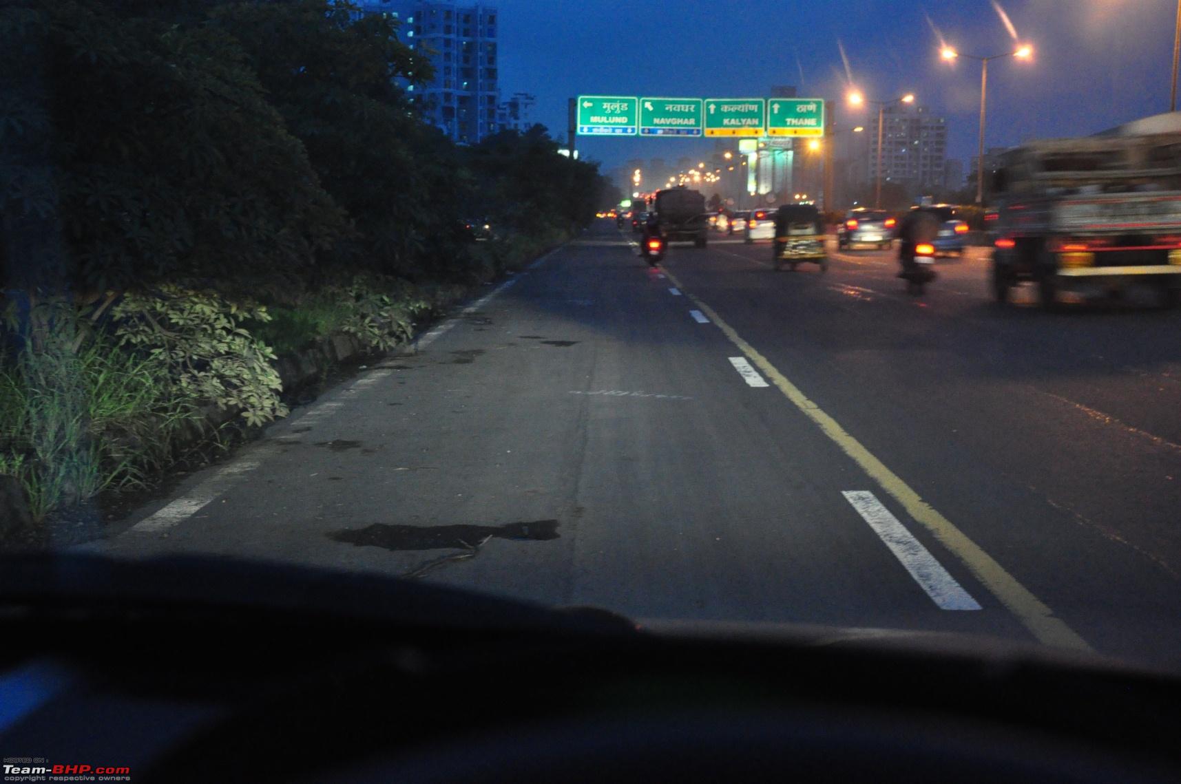

Originally Posted by mannubhai View Post
Sathya, Are you talking about this dark spot ? Im having thisone from day one, and the RM and service team says, M&M hasnt been able to figure it out. I drive with the dark triangle on my RHS ever since .
Attachment 961187
SDP, my RHS led conked off ... Now i realise many things have conked off
Mnnubhai but where is your left side lower beam?? In the pic, i can see only the righthand side beam with that triangle but no left beam

Originally Posted by SDP View Post
Hey, thanks for clarifying. I believe I have the same problem. Would take a pic for sharing and would also try to debug.
I too reported that during my first/second week of ownership. That looks to be a safety feature but at the same time it doesn't provide good illumination on highway speeds.
I can clearly see that the lower beams creating a very good focused illumination in such a way that if an oncoming person, walking or driving at around 50-80 meters range or so, he want get blinded due to the light, I can see that clearly since the face of a person is outside the illuminated area while he is within certain distance from the car. This prevents blinding of oncoming vehicles and superb lighting (I feel XUV has good/powerful lights in the category) in area its required to be.
However, at the highway speeds, this throw is definitely short when I was driving on NH7. I had to use the high beams very frequently to illuminate the area beyond certain distance, since they have prevented the throw beyond certain distance, the low beam isn't effective. I have had a couple of sudden surprises when I was driving around 70-80 kmps on Kanakpura road (some sudden sharp turns) and had to turn the high beam ON all the time (which again is very useful and strong light illuminating real good distance while driving, but may annoy the oncoming vehicles). All this experienced while the low beam level adjust set to 0 (highest possible level). This is a feature. Guys who always keep the high beam ON during highway drives, may not even feel this. short throw on highway is a bigger concern compared to that triangle or so called blind spot.
I'm planning to get this fixed during my next visit to SC. However, I was waiting for an update from Naveen or till the time I look at the manual for such an option so that we can adjust it DIY, I want to keep this low beam a bit higher than the current 0 settings with level adjust set to 3. so, when I set it to 0, it should really help me on highways, during high speeds, covering good distance with the throw.

Originally Posted by Wind View Post
I too have observed this batch patch at the start of the throw in my XUV. I was under the impression that it was one among the myriad features of the Cheetah :-) . Thanks for bringing this up. I will ask the RM to look into it during the next visit to the service center.
Did you ask the Service Center folks to raise the low beam? The reason why I am asking is, in the original position (factory position) of the low beam, I did not have any black patch immediately after the car. I had the patch like what Mannu has shown.
This was the one I had before I adjusted the light - low beam. Now after raising the low beam manually from the engine compartment, I do not have this patch any more. The throw is good or even superb. I rarely go high beam now.
But the guys at the SC have raised the light a little too much, so that I have a mild dark area immediately after the car which goes away if I switch on the fog lamps.
Yesterday, was driving back from office at 11PM and found the lights (low beam) to be very comfortable along with fog lights. Just that I need to lower the beam a little bit if I have to stay comfortable without the fogs. I will be along with the SC folks next time when they adjust, so that I can adjust this as a DIY if I want to.
Originally Posted by naveenchhillar View Post
Sathya,
Yea, I asked them to do the same in front of me & saw the position of the screw. Will try to take a picture of the same location & post it here.
Was fairly easy, must say.
Meanwhile, you can try to do a little bit from inside the cabin. The vertical rollbar on the right side (near to diesel tank open button). If you want to lower the beam - please try to go to position that's numbered 3 against it. 3 is the lowest beam possible that can be done from inside.
0 is the highest in terms of beam.
Naveen, if you can post a pic, it would be great. It would help me avoid a trip to the SC. The one inside in the cabin only adjusts the high beam.
SDP,
Im talking about the area beyond the blue line. Thats the dark triangle formed. It is not visible in high beam though.
To add, the photo was taken under diary circle, and the light was pointed towards slight elevation. On a normal even road, the dark portion is menacing. Especially when one is driving along side the divider, and when those stones are left over on the road, you tend to not see them due to the lack of light.
Originally Posted by sheelapratosh View Post
Folks, I have this exact issue. I checked in atleast 10 other vehicles - all of them have the same issue. I dont know if its by design (or) yet another niggle.
Here's a snap taken today. Notice how the right hand side headlight throw is clipped? I am going to get it checked. Hopefully adjusting the bulb/housing should solve the problem.
PS: Photo taken with the headlight leveler on 2 or 3 (in a empty vehicle). With the setting on zero, the clipped portion appears farther away and is noticeable only if you are a keen observer.
Attachment 962182
This is a headlight design with an aim to prevent the headlight beams from hitting someone from the opposite. Had the same doubt however the RM showed me about 10 XUVs and then explained that it was a deliberate design. So not a niggle.(Thank God some would say )
pavan15 is offline   (4) Thanks
There are guidelines which stipulate the beam throw pattern in cars keeping in mind road safety and the glare that comes on to the opposite traffic. The RH beam is thereby clipped by design. If you were to go to a LHD country, you would find the LH beam clipped.
Headlamp - Wikipedia, the free encyclopedia
Read the regulation part of the link.
neel385 is offline   (4) Thanks
