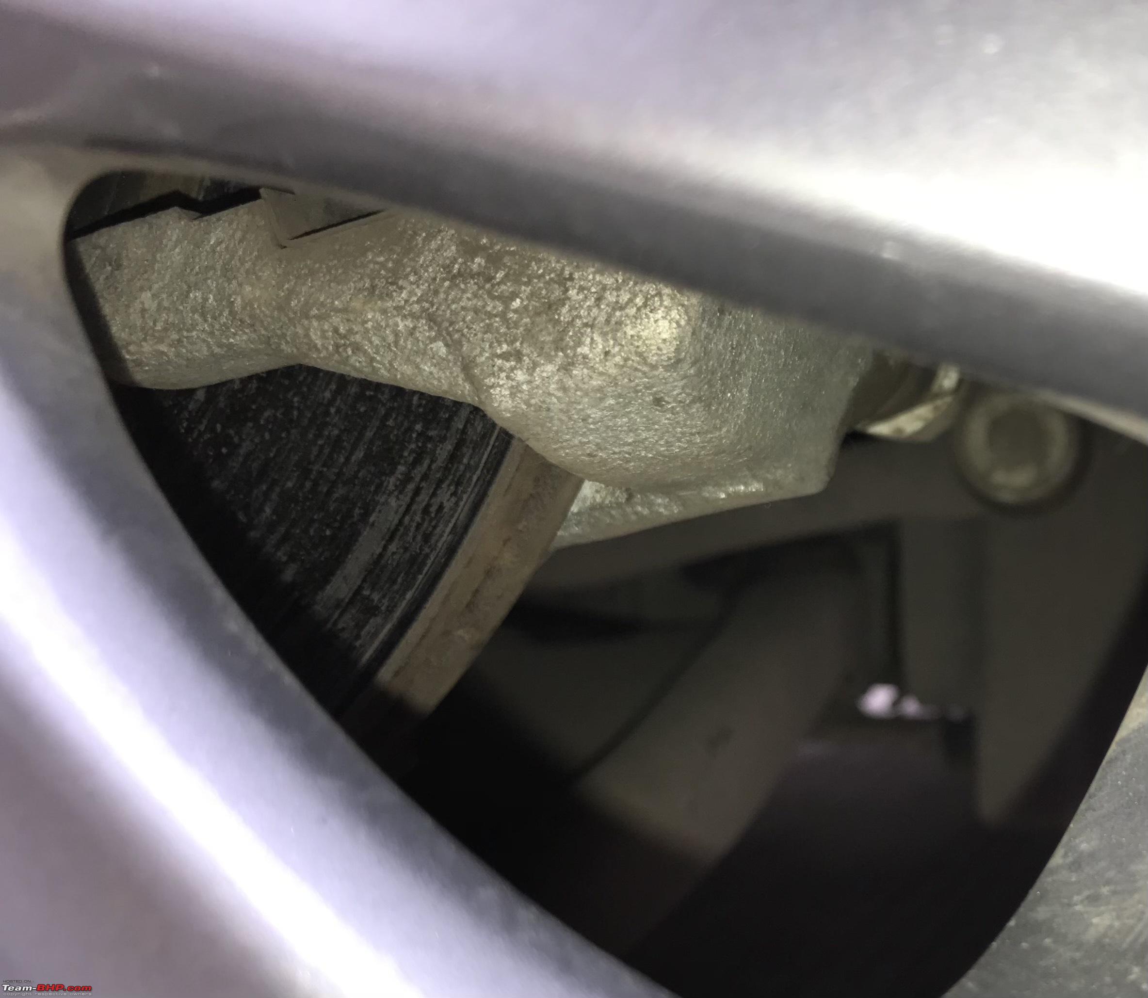

I need some help with brake pedal vibrations on my Baleno. Its run about 5900 kms, but since last 1.5 months I have observed that while lightly braking at higher speeds (more than 50 km/h), I feel vibrations on the brake pedal.
The service center guys mentioned it may be due to rusting of discs and everything else is fine. But I see only rusting at the disk edges and not on the surface. However there are some marks and scratches on the disks. There are no deep grooves and the disc surface is smooth. I have attached some pictures. I need help from any forum members whether these could cause vibrations, or is it indeed the rust on the edges.
I can push for replacement in warranty if there are scratches causing vibrations even with low running. I don't think warranty will work if rusting is the culprit. Would appreciate any guidance.
