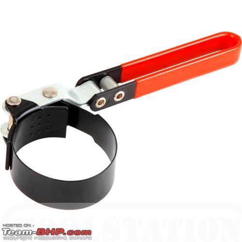

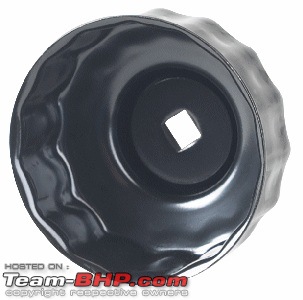

Recently I tried changing the oil filter on my Versa. It is stuck underneath like in an Alto and not easily approachable like in a MJD engine.
Ok, so now used an adjustable oil filter wrench, but the thing just wouldn't budge. Then drove the car about a bit and tried again and the filter would move about just a bit. Used a strap type wrench and it just kept slipping off. Finally went to a neighbourhood mechanic and he used a socket. A kind of cap that fits on the oil filter and it came off in a jiffy.
Now where the hell can I find such a socket cap for a maruti oil filter online. And what would be the exact specifications. It would be a huge relief if I could change the oil filter myself as well.
Would a 65 mm cap be enough because the diameter of the oil filter seems to be 60mm.
There are several types of oil filter removal tools available.
One is a strap on type tool like this:
Another one is a socket which fits at the exposed end of the oil filter and requires a ratchet to turn it:
Another one is a plier type which has tooth like protrusions and grabs on to the end and is self-adjustable depending on the size:
You’ll have to pick one depending on the type/size of filter on your car. I like the plier type. Been hunting one for sometime now.
Source of pics: Google images

Re: Maintain the car yourself. A service checklist
I need the socket. I hate the strap one or the plier or the adjustable type. The socket can exert the maximum possible torque on the delicate plastic filter that today's vehicles have.
I tried a cuff type filter wrench on the filter and slowly it started to disfigure the filter the harder I tried. the strap type filter wrench will simply keep slipping if too much pressure is needed and thus my insistence on a socket. But these things seem to be simply unobtainable in spares market in my neck of woods. Amazon has a list of sockets but god knows which one fits on the Versa filter.
Would this be enough ?
http://www.amazon.in/Drive-Flutes-Fi...+filter+wrench
how the hell do I know without trying it on first.
