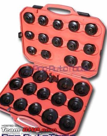

Originally Posted by lurker View Post
I need the socket. I hate the strap one or the plier or the adjustable type.
Would this be enough ?
how the hell do I know without trying it on first.
Yes, I have measure it. It is 7.0 cms.
You can consider buying one of these - will fit most cars out there.
Image Source: pro-autotools (ebayer)
Since your location seems to be Meghalaya consider using a transhipment for the item through a service provider such as this
Hope this helps!

Old 20th December 2014, 21:59   #320
lurker's Avatar
Location: Tura
Posts: 1,613
Thanked: 1,478 Times
Re: Maintain the car yourself. A service checklist
it's available on indiamart too. seller wants 7100 for whole set. And what am I going to do with the whole set. i ordered a 68mm socket off ebay. Yet to arrive, meanwhile asked a fnm to unlock the filter and he did it easily with a socket (as you have shown) and a drive.
lurker is offline
