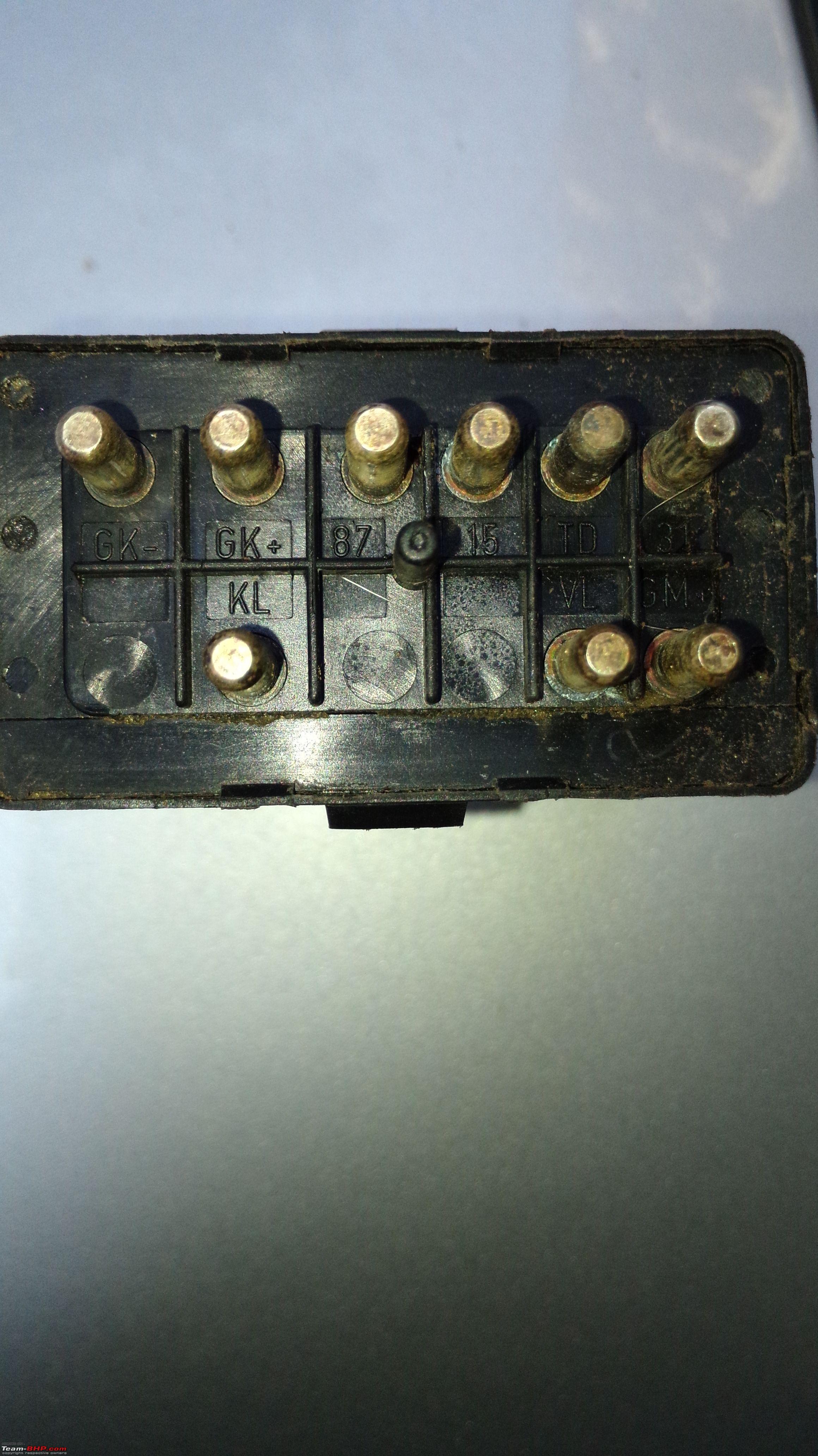

The problem is that, i do not have a AC relay,the AC chills,but it leads to Ice formation on pipes under the hood,which blocks airflow for sometime.
Winters are here, and AC's are off,so i wont need to attend to the AC until march,lots of other issues to take care off before that
Btw i have found two parts,not sure which one is correct.

The picture on the right, is actually the relay from my car - my brother is holding it! There are two different numbers, but both are very similar. The relay in the picture came off my car. Not sure about the Kilma relay - part number looks different?
