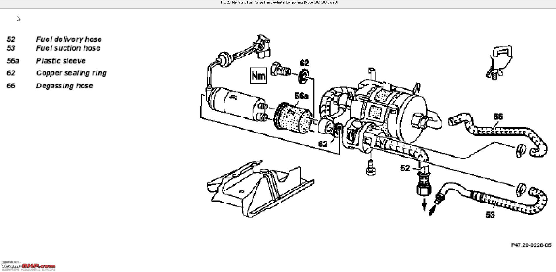

Re: Mercedes W124 E Class Support Group
I thought I would upload some pictures of the fuel and evap systems on the W124 series for you guys. Most of the pictures are off the M111 engine, but if you need information on the larger engines, let me know.
