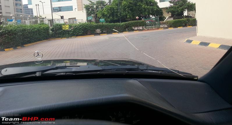

I need to replace W124's windshield because of hairline crack.
Windshield Experts, Bangalore quoted around Rs 28500 all inclusive, with Saint Gobain glass.
Car Mechs quoted around Rs 17500 all inclusive, with glass of unknown make. I think he sources it from New Delhi.
Now I am in a dilemma. I would like to have Saint Gobain glass, but not sure of Windshield Experts to carry out the job with factory finish keeping all the trims together.
Your suggestions please. Is there anyone else in Bangalore who can do this job ?

First of all press windshield expert a bit more, they will come down to 21-22K; I had taken a quote few months back.
Secondly on brands, prefer OEM and as far as I know Saint Gobain aint MB original, but I can be wrong. As long as they are good quality I would not fret about china or saint gobain
Now to the important part
1. Whichever brand you choose, ensure that the glass comes with a black channel attached to the bottom part of the glass on which your wiper cover gasket will hook on. If it does not have that channel you will have water leaking; this channel cannot be bought separately comes with the glass. Some cheap brands don't have that, so check
2. Take time removing A pilar weather strip / chrome strip; if the clips break replace them, you can see the part numbers in my restoration thread. Don't worry about the metal clips, you can pop rivet them again. Ensure all the metal one are tight [check my restoration pics]
3. Rest its standard glass job, anyone should be able to do
I have mailed some manuals which will help you on this job, cant upload here as size is prohibitive; ignore the part where hood needs to removed or special tools, leave that to the glass fixer, you just be careful of the above points I mentioned

my experience with non-branded glasses from China and Taiwan is terrible, the glass quality itself is not good giving uneven view leading to splitting headaches on a long drive and the night was even worse because of light refraction from on oncoming vehicles and the distance estimation at high speed also becomes an issue, I had to go back to the OEM glass and spend all over again. I hope you get the picture
Please stick to OEM brands and go only to professional setup using quality materials.
2nd point is, why did you get the crack, is it a stress crack or due to external damage, if stress crack then is there any body warp?
Please do the root cause analysis

Please go in for the Saint Gobain windshield. It costs about 20K here in Delhi, so bargain with Windshield Experts accordingly. Do NOT go in for the Taiwan crap. I have that on my E220, and it is an absolute nightmare in the winters, the glass fogs up between the laminate, and no amount of wiping will get it clear unless you spray water on it. Although, I have not had the refractive issues that Anupam has faced.
The Taiwan stuff costs about 5K though, and Bangalore doesn't have much of a winter, so maybe the fogging issue won't come up? It's something to consider, but I'd still suggest going in for the Saint Gobain.
As far as the matter of originality goes, the original W124 windshield was manufactured by Sekurit, which is now owned by.. you guessed it. Saint Gobain.

Thanks a lot for your guidance and very informative replies. Accordingly I will insists on the branded glass. I will also try to obtain a quote from MB dealer before taking further decision.
Now coming to why did it happen ? I have no clue. The initial crack around 6 inch appeared when the car was parked under a tree shade in afternoon. It was not hot day and I am sure nothing ( fruit or stone ) is dropped. Looks it fatigue related failure. After a couple of days the crack grew to 8 inch long. In last 3 months, it has remained as it is. There is no water leakage. I don't think there is any body warp - it has always been sedately driven and only between home and office - during off peak hours and on very good roads. The body feels very tight.( I know it because I had owned an Esteem - the nightmare as far as body flex is considered ! ) The car is so well made and put together ... Because of this very reason, I am reluctant to get anything done unless I am sure of 100% quality.
How much total time since the initial crack? We don't know the reason yet, so how do we know that it will not reoccur
Since there is no immediate impact on daily run, I would recommend you to take it easy and spend more time in researching the root possibilities, and hope to find the most likelihood reason
And not that you may want to opt but if you are covered comprehensive then the windshield is covered
