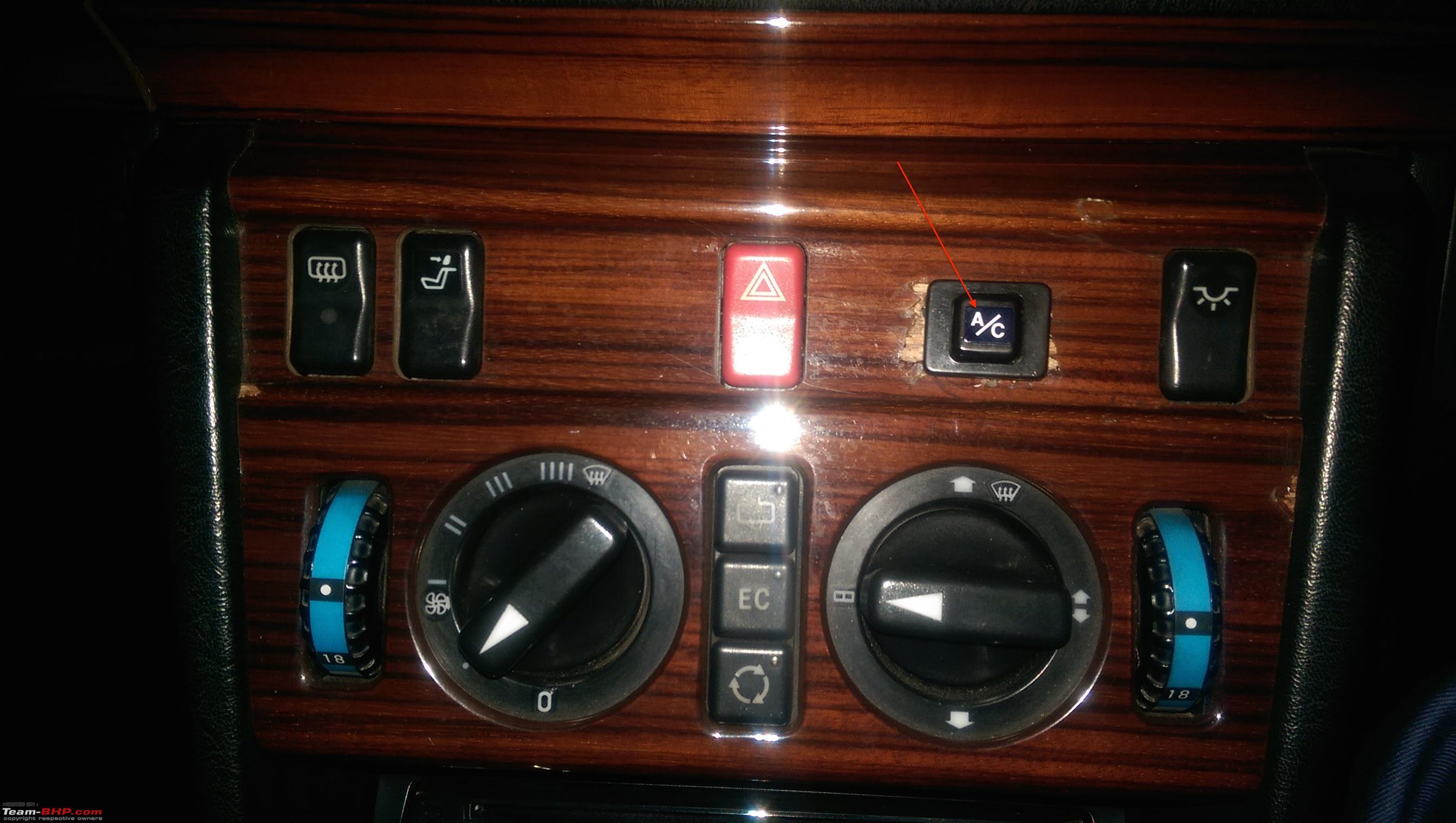

I am currently using a 1996 E250d manual that has done about 119000km. i have questions about some issues i have been facing,
1) the engine noise inside the cabin is too high. even at 30-40 kmph its too loud, i know the 250d engine is louder than its petrol counterpart but the noise is too high and can hear it over the sound of the stereo as well. i am asking because we haven't been using the car much for the last 6-7 years and when i last used it i remember it being much quieter.
2) what happens when the blower speed is set at 1,0 or "." positions ? my car has a button for a/c fitted ( not by mercedes themselves) will post a picture soon, it only lights up when blower is set at position 2 or above. there is no cooling occurring when blower is at position 1, just air.
3) most of the time i have to crank 2-3 times to start the car. what should i be looking at to solve this ? can this be due to using a non-original key, the original keys are lost so the drivers got another one made. can i order the blanks from mercedes india or i saw some blanks for the w124 being sold on ebay, can i buy them and get them cut ?
4) the accelerator pedal feels loose, i can move it side to side by hand, would it be just some bolt coming loose or some clip behind the accelerator being broken ?
thanks in advance.

1. Service your engine for any faults; like belt etc; which might be contributing to the noise; If all is in good health and the outside noise of the engine is normal; however in cabin noise is higher, then start looking at the door seals, whether they are sealing well [bad seals let a lot of wind and noise in], what is the status of the under hood insulation? was the dashboard ever removed; if yes was the insulation put back properly? are the under mat insulation there? are the windows sealing well?? lot of things to check
2. Not sure if not OEM MB; however "." on blower switch is just air; no cooling
3. When you mean crank; does the engine not make the cranking noise at-all?? if that is the case, I guess it can be the key unit electrical / vaccum, or battery voltage? fuses etc
Else; it can be fuel filter, accumulator etc
4. There is a bolt; tighten it

will be getting the engine serviced next week. The front drivers side door rubber is deteriorating letting in wind noise, so already planning to replace it. will report back once it gets done.
Sorry what i wrote may have confused you. The blower speed switch is OEM, I am talking about another switch added on to the panel as seen in the attached picture (sorry for the bad picture). the button was added on (very poorly). the A/C only comes on when the blower speed is set to speed 2 or above. when set at speed 1 only air comes through no A/C. the A/C is really effective even in 40C weather and some times speed 2 is bit too much for me.
so was wondering if something is wrong when blower is set at speed 1 as A/C is not coming on ?

Thanks a lot for the help. Will report back once i get the work done. any advice regarding headlamp bulbs? I travel mostly in rural roads with lot of unlit vehicles, people and animals crossing the roads. I am looking at Osram nightbreakers unlimited but they are a bit hard to find where i am as i want to test them before buying them.
