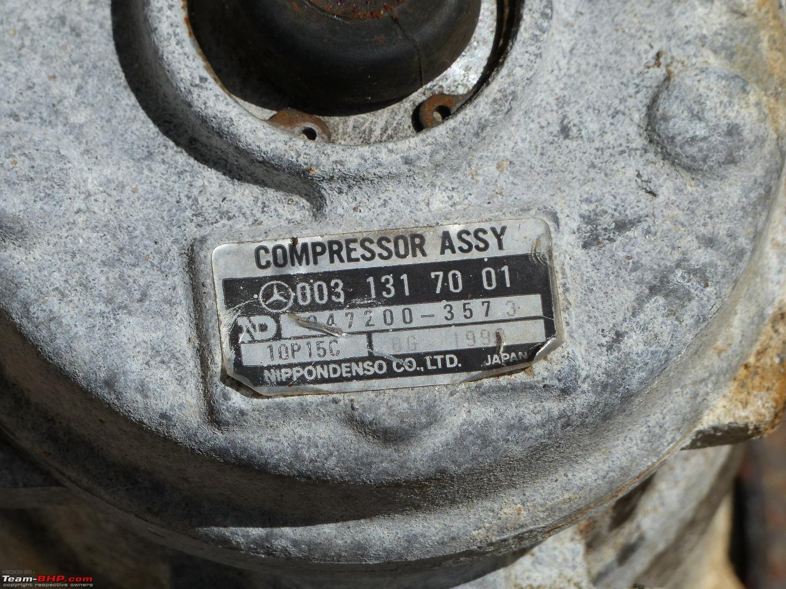

Shanky, is this the compressor that goes on your car?
Ray32825 is offline
Looks familiar though. ..need to check the part no

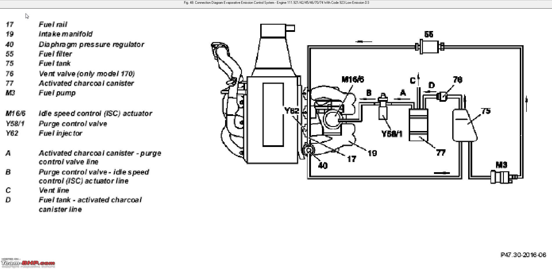

Well finally I got my car running after a fuel pump failure. removed and cleaned the tank, installed new hoses and pump. Fixed a broken breather valve, Filled it with 50 lts of petrol, idled for 45 mins to check for leakages or any malfunctions. I still hear small noises from the pump, as in it is not absolutely quiet. But a periodic " zzzz" after every few seconds. I will check fuel pressure at the rail. Any ideas what pressure should I be expecting to see?
Are your pumps dead quiet or is it inherent as per design? I can only hear the noise when am under the car with the pump cover open

I am beginning to conclude its heat related. Buzzing goes up with heat. Heat may be from hot air blowing from the engine underneath or when running low on fuel, air gets sucked in of the fuel level goes below strainer height thus causing pump cavitation coupled with heat causing vapor lock and pump overheating..lets see...

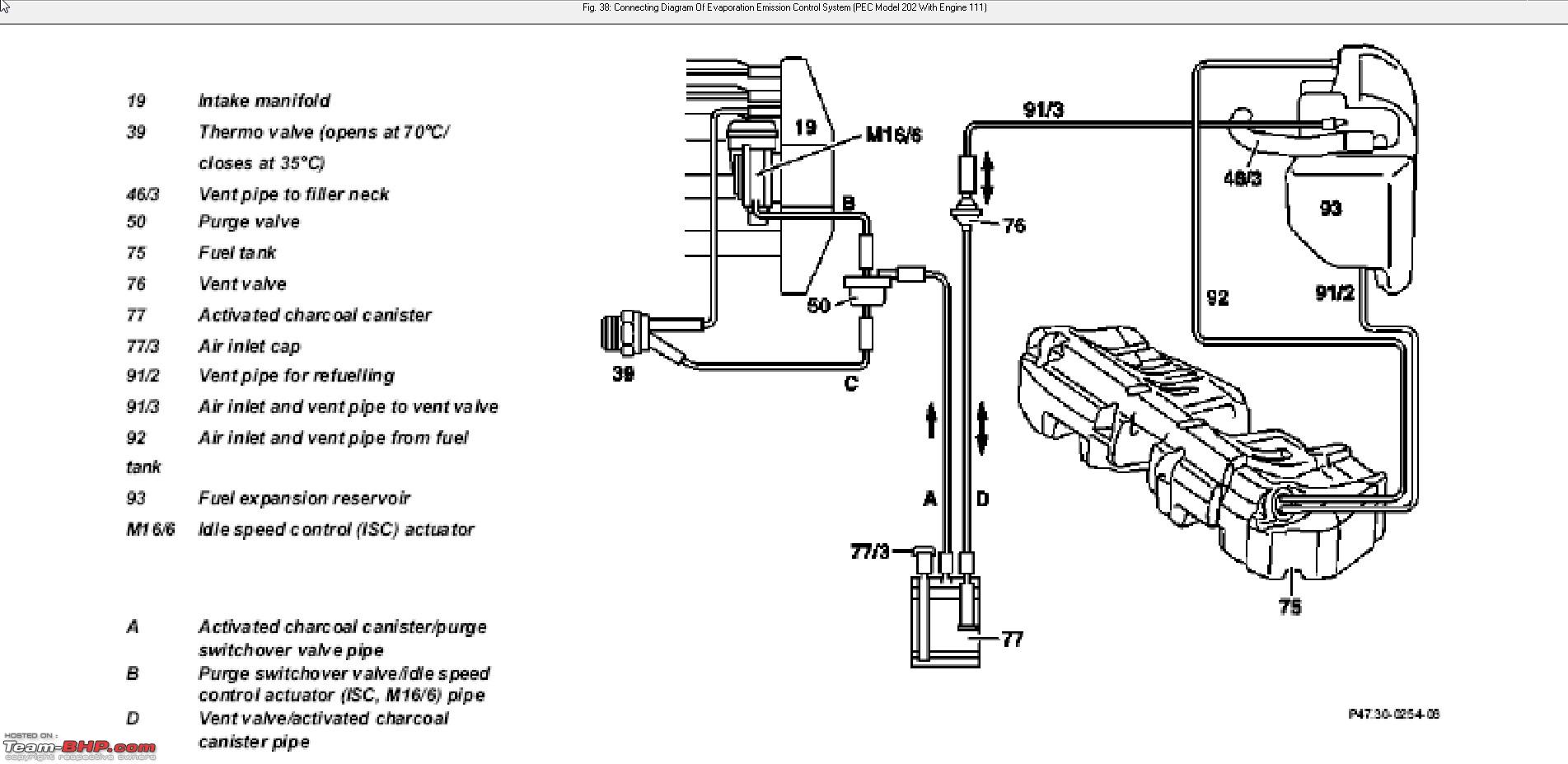

This may help, its for a M111 engine
