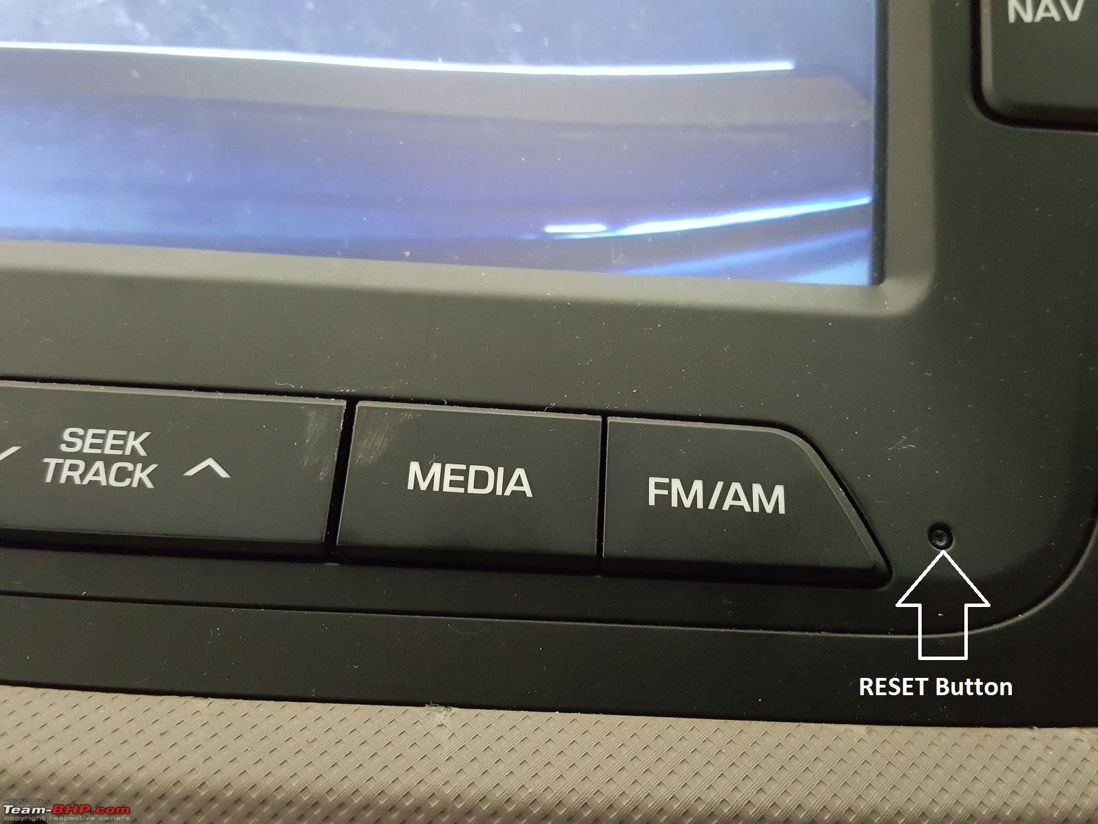

Its been around 8 days since i took delivery of the SX+ AT CRDI.
I am loving it, but have faced the 7" AVN hang issue.
First Hang was last Sunday 28th Aug and the 2nd today 2nd Sept.
The first time i had to pull out the battery terminal to switch of the unit.
Some googling later in the evening helped me find an article which talked about the reset switch on the 7" unit.
Today when it hung, i just pressed the reset switch and in a min or so it rebooted. Back up and running.
I hope during my 1000km service they can upgrade the firmware and resolve this issue. Else i just need to keep a pen/pin handy instead of the spanner.
RESET SWITCH

I faced the hanging issue for the first time this week. Had to leave the system on for around an hour. Read the navigation manual and found the reset button.

I faced the hanging issue for the 3rd time since the ownership of my car which is around 7 months now. Had to switch off the car completely for a few minutes and start it again to turn it on.
