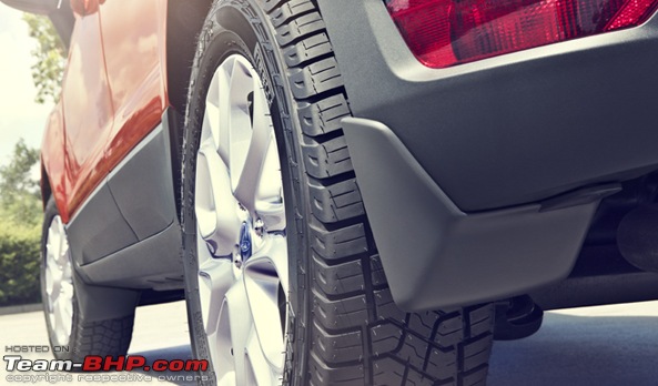

Also curious what's this tyre which can be seen in Ecosport official accessories page:
Ford Ecosport : Tyre & wheel upgrade thread-1249024357080.jpeg
Seems like a AT tyre. Is there any advantage of using AT tyre in 2WD vehicle? Also are there any options in Indian market which will fit the 16' rims?
When I checked there were no AT option on 16in rims in the permissible deviation range. There though was a model in 15in.
My P7s are doing very well are at 5k use now.
The problems I believe occured with the 90 bhp diesel version. Mine is 112bhp petro ATl. I think at 100 plus bhp you should be ok with the 225 size upsize. Am enjoying the comfort and dynamics.
Another variable could be driving style and if one only gently taps the acc then the upsize may not be suitable. I have a heavy foot normally.
FE drops 5%.

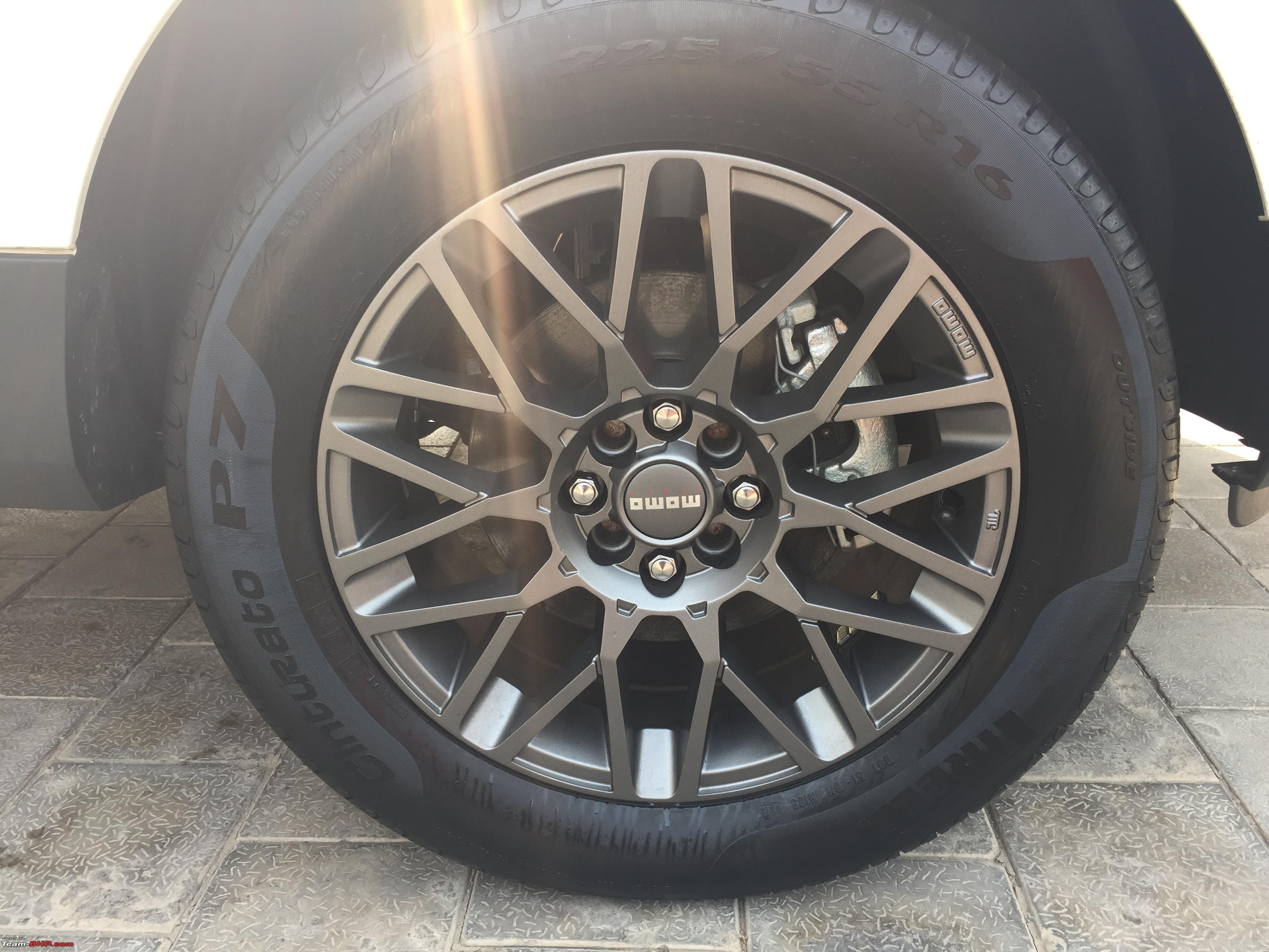

Here is my rubber... Went with Perilli P7 225/55/16 and a set of Momo's:

Ford Ecosport : Tyre & wheel upgrade thread-img_1278.jpg
Ford Ecosport : Tyre & wheel upgrade thread-photo-20151111-11-11-52-1.jpg

Old 12th November 2015, 12:03   #145
ranjithrnair's Avatar
Location: TRIVANDRUM/BANGALORE
Posts: 219
Thanked: 97 Times
Re: Ford Ecosport : Tyre & wheel upgrade thread
Aseem - Would you mind sharing the cost of Alloys and Rubber here .
Thanks,
Ranjith
Originally Posted by saisrujan View Post
Now that the prices are out, I have some wiggle room to spend on accessories. I'm planning for the ecoboost titanium (o). If I end up with the MRFs (not much control me / dealer should have), I think it is best to replace them immediately. I'm not keen on up-sizing, I just want the best possible replacement in the same tire size - 205/60/R16. Any help, please?
Originally Posted by WasavaTyres View Post
Try and get them to give you a car shod with Goodyear Assurance tyres. You can avoid losing money on brand new (the stock MRF's) tyres when you go in for an exchange.
My opinion is quite opposite, may be because the way I drive is different from yours. My EcoSport ambiente came with Goodyear assaurance. At first I was praying to get these tyres, and now I wish I had the Mrfs. Reason being the goodyear is not at all suitable for broken roads. It is a amazing tyre on highways and cities, very less sound, very tight grip, amazing ride quality, but if you want to take your car down from the main road, to some broken one then these goodyear soft tyres would give you hell of a time. My tyres are already punctured twice and side wall cracked on my first road trip to Himalayas. I had to replace them while coming back.
Its time for me to change the tyres as well. In Kolkata where I stay the roads are pretty bad in shape, naturally I want a higher profile tyre for my 15" rim. The only tyre which I can see is good for both mild off-roading and onroad is Earth-1. The size available is 205/65 R15. Can anyone suggest any other tyre ? Is there any AT tyres available within this size ? I couldn't find any.
Uprasenjit is offline
