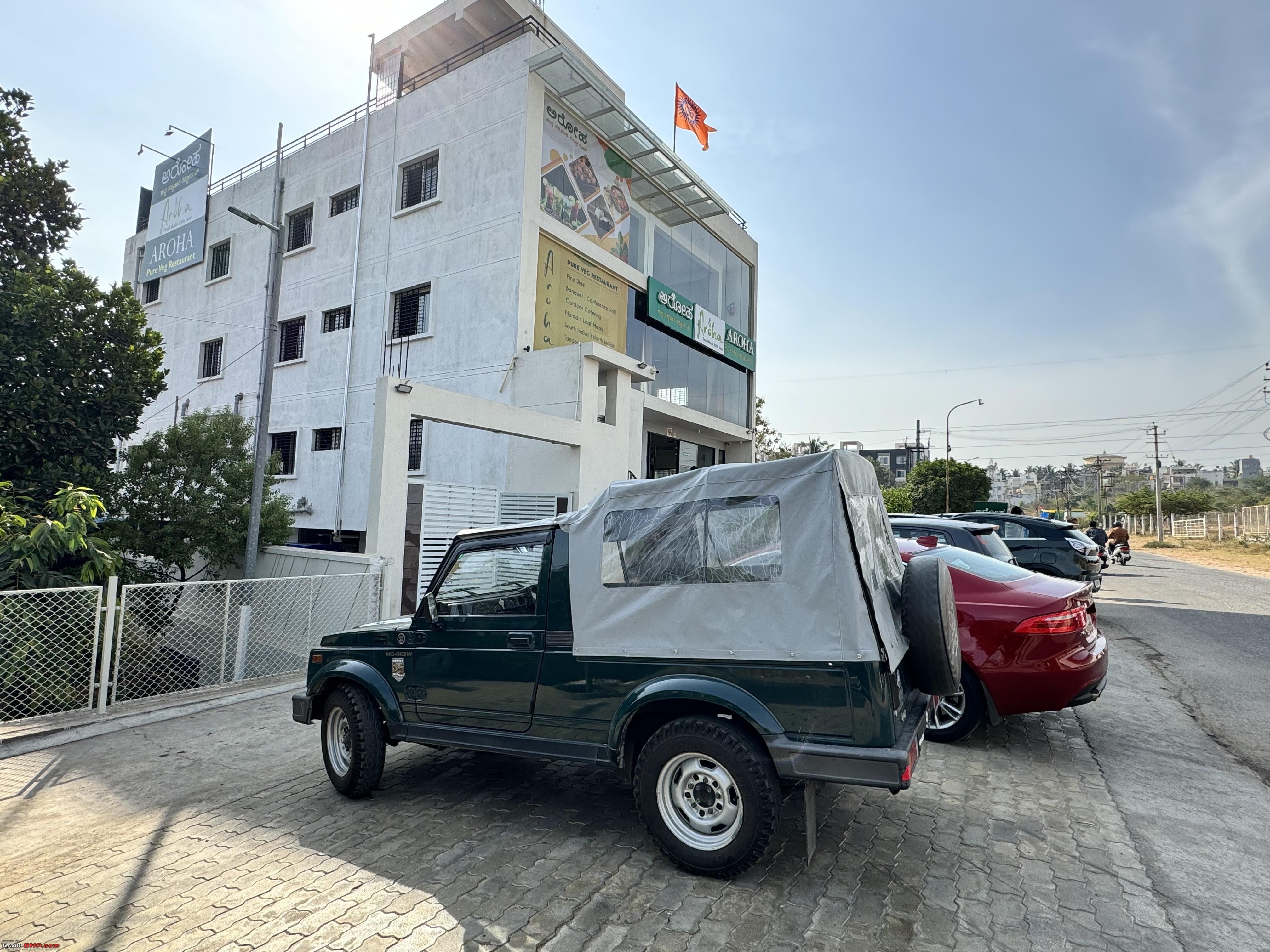

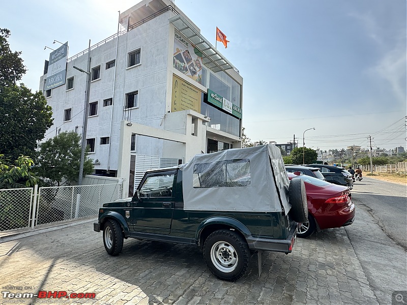

All my Thar Accessories - underbody plates and suspension parts and so on, are packed and secured in my Gypsy’s Cargo Bay. It is a perfect baby pickup truck. ready to drive to Mysore and drop off to my friend who will use all of these well. As a well designed compact yet LWB utility vehicle, only a pickup truck or small truck can beat a Gypsy.

Mission accomplished today!. Left home at 545am. Drove peacefully along the Mysore Highway. Didn’t exceed 70-80kmph. Stayed in the left and middle lanes. Reached the rendezvous point at 0810. Met my friend. Had a solid brekkie. Trans-shipped all my Thar Accessories into his Innova from which he had removed all the seats to make a huge cargo bay. Parted ways. Left at 0930 and Drove straight back. Kept to 80-90 max. Middle lane mostly. Filled petrol near Ramnagaram. Stopped again for some work for half an hour in Hosur Road. Back home at 12 noon.
The bone stock non AC, non Power Steering, Nylon Tyred, soft top Gypsy is an admirable vehicle indeed. A real utility steed and work horse. Lovely vehicle.
