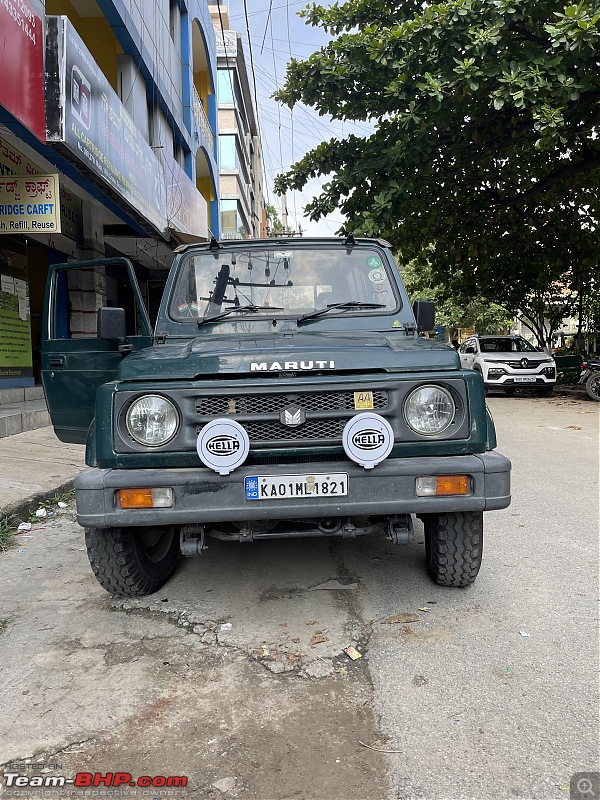

Small and essential add on for any Gypsy. A pair of good quality Hella Comet 500 FF Foglamps.
Cleanly and competently installed at a local auto accessories shop with the out of the box relay, earthing and internal switch. Just two holes drllled in the metal bumper and the clamps bolted on strongly.
And then a good solid car wash to get the Gypsy nice and clean. Other than these foglamps, I have only added on the mild steel fuel tank guard.
The military versions come with factory fitted lamps which are much smaller and fitted closer to the edges. Are these adequate?

I decided to mount two large 140 watt Australian "Light Force" lights from Bimbra, Gurgaon. I am careful to point them slightly to the left and out of the eyes of on-coming traffic. I turn them off all together if a vehicle comes. They are for use in the mountains at night.
Nothing really helps you see thru fog, NOTHING! But these truly light up a clear black night in the boonies. If you just want to be seen by others e.g. in fog, or as daylight running lights, then smaller good quality lights will help, and LEDs will be okay for that IMHO and they are easier on your electrical system than my big ones.

Wow! 140W is massive. I used to use 120W bulbs in my enfield and the throw of that was amazing on dark roads. Truck drivers would flash when on high beam. I changed that to the regular 65W ones as it was heavy on the electricals and mechanics were not sure what to do when there was a problem.
I was posted in Assam for 2 years and the fog is thick and suddenly comes down on you. Lights were useless and the safest thing to do was to switch on the blinkers to get noticed.
When does one need extra head lamps on a vehicle? I remember doing a night drive in heavy rain on Chorla Ghat in the gypsy. Visibility was very poor and the existing headlights just about lighted the road ahead. Not sure if extra head lamps would add significantly higher value. Maybe headlamps mounted on the bonnet at arms length from the driver and co-passengers side would be more useful.

Originally Posted by DirtyDan View Post
I am careful to point them slightly to the left and out of the eyes of on-coming traffic..
Good point ! Thank you.
Originally Posted by SJ410 View Post
Not sure if extra head lamps would add significantly higher value. .
Doubtful, IMO. Just like the moisture droplets in fog can disperse regular light, so would rain drops absorb, deflect and disperse any light falling on them. Guess you would have had a brighter near area with those extra lights, but not much effective/useable light further away.
... the safest thing to do was to switch on the blinkers to get noticed.
When does one need extra head lamps on a vehicle? ... Maybe headlamps mounted on the bonnet at arms length from the driver and co-passengers side would be more useful.
Yeah, blinkers get people's attention. As Condor said, fog dissipates light and it doesn't matter much what color you try, e.g. yellow lights don't cut fog any better than normal lights. They just look cool.
And, if you up the wattage, fog will dissipate that, too, pretty much.
It also depends on where you mount them. If you mount them low, you might many times get more benefit because there often is less fog close to the ground. You may also cause more shadow from holes and rocks, making those more visible. But, if you do that, then you risk damaging your lights by hitting low obstacles, cows, mother-in-laws, speed bumps and such like.
I would not buy big ones like I have again. They aren't that useful.
Auxilliary lights do help you to be seen by others, though, and given the ability of the average Indian white board driver, that's not a small thing.
When I come to a particularly black, nasty patch of mountain road, I switch my big lights on to make sure of whats in front of me. Once assured, I turn them off again. I rarely have them on for more than 6 seconds. There is no need. I tend to keep them off. It cuts down on the UFO reports.
Secondly, does the position of the fog lamps affect the ram cooling for the vehicle? You may not face this problem but I stay in Chennai and use the gypsy as a daily drive. In traffic the engine heats up and cools down by the ram effect of driving on a relatively open road.
Not much, I would say, as it is not pure ram cooling, but the fan also pulls air from behind the radiator. Gypsy engines are prone to overheating at slow speeds, on city roads.
When I complained to Daga Autolec, Chowringhee Road, Calcutta (who had fitted the AC on my MG413W ) about overheating, the proprietor pointed to the two flood lamps, one spot, and two fog lamps I had on the lightbar in front of the radiator grill. So I removed them all and drove for some days, but there was no difference.
I reinstalled the lights, and now keep a close eye on the gauge inside the city, but it rarely goes above the halfway mark.
