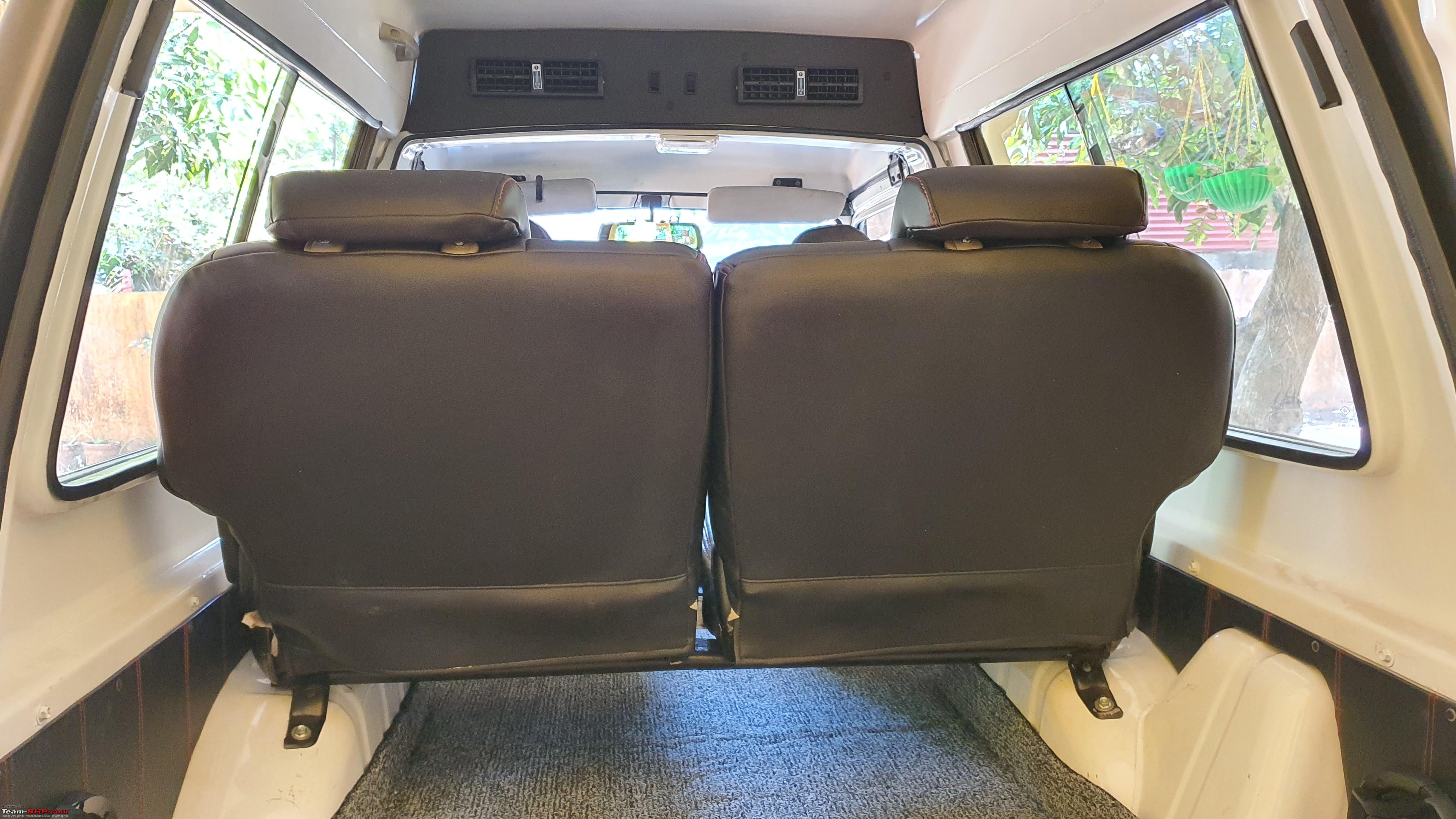

Originally Posted by SJ410 View Post
Thank you
Innova 3rd row seats fitted in my Gypsy
valapad is offline   (4) Thanks

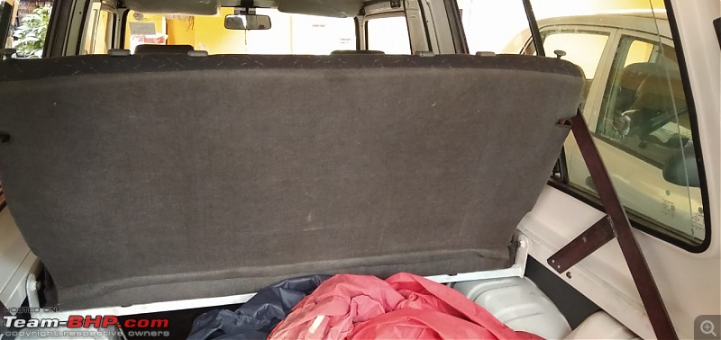

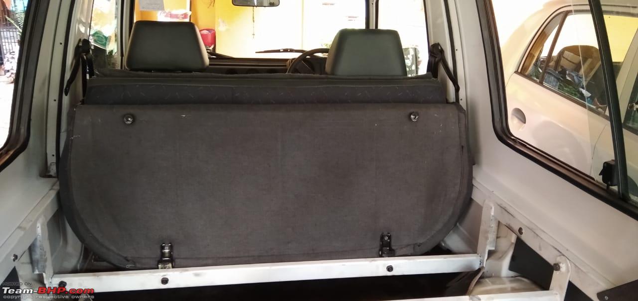

I had this custom built seat in my hardtop with a full length storage box underneath the squab which I used regularly.
keroo1099 is online now   (4) Thanks
Thanks Vapalad. I see a neat AC blower fitted over the B section. Could you post pics of that? Where is the ducting?
Also the grab handle behind the passenger seat. Is it bolted onto the fiberglass frame?
SJ410 is offline   (2) Thanks
I built the seats myself. Used old santro seats from a scrap yard which fitted the 125cm width perfectly.
SJ410 is offline   (3) Thanks

Far out, SJ410, please post front views of seats as well.
valapad's Innova seats look real good, almost too luxurious for Gypsy ! I too am curious about the A/C vents -- are they just blowers or with ducts ?
Any pics of the under-seat box in keroo1099's vehicle ?

Hello
I am interested in the details of the overhead AC vents in the pics. How did you route the piping? Is it stock blower? How did you split the multiple pipes going into dashboard vents to route the extra piping into the overhead vent? Some piping pics would be nice to see if you care to share.
Thanks!
