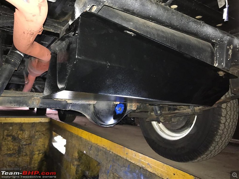

It is worth putting a mild steel fuel tank guard in these Gypsys. I’ve done that on my old one and on my new one. It protects the sheet metal tank from sharp stones and all. Long ago (1997) I ve experienced a fuel tank breach on account of a sharp stone and it isn’t a pleasant experience. In those days also the tank was made of sheet metal and a sharp stone breached it while driving over one of those flyovers which were under construction in Madras. I had to resort to WW1 biplane pilots tricks of locating the breach and the. rubbing soap over it to staunch the Petrol leak. And for good measure put some chewing gum and sticking plaster on top till I could reach the garage and give the vehicle so that they could drain the tank and remove it and solder the leaks with brass/ copper. It took 2 days of work at Kamlesh’s Garage, Electra Automotive in Madras. He was the Guru I used to go to those days. And I was out of action on the weekend with no vehicle.
In ref to the tank capacity. It is 40 litres. The fuel gauge needle is a bit vague. It stays persistently near the upper half of the gauge markings for a long time and then when the actual fuel in the tank reaches approx the 15 litre mark, it suddenly drops whoosh and shows as near empty. This has been my experience with all the Gypsys I ve ever owned.

Mild sheet fuel tank guard is a great idea. Any place I could get it done in Chennai?
As of now I dont want to get the tank opened up as the vehicle is functional. Once opened there is a risk of the vehicle being marooned till a part or replacement comes in.

Suggest buy this from Prad or Swastik Fabs in Bangalore. It may cost about 4000/-
Here is a pic.
Ref the fuel smell. Probably the vapour more than anything else.
Here is a pic.
Thank you. Will get in touch with them.
Yes vapour smell. Is it normal?
