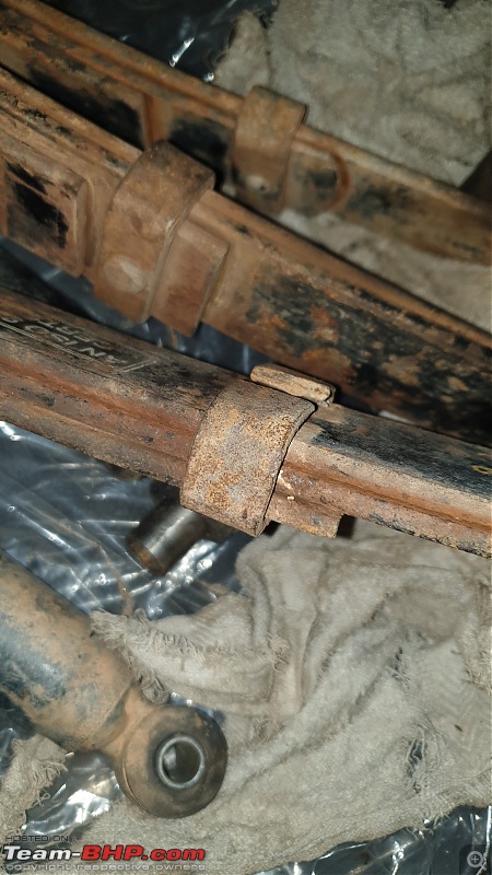

The below image is of my earlier stock leaf spring. Note the clamp without the bolt.

Chill! No tension! I experienced the same with Ironman kit. I got a 1” wheel spacer from USA but I think you can find one locally at Swastik Fabs I think. Just make sure the spacer you buy comes with its own lug nuts or studs and holes to bolt-on to the original hub. These will give adequate stud length to affix your tyres to. The ones that don’t come with their own lug nut and use the original are just like washers and as a result you will have 1” less stud length to fix your wheels.
I am using these ones since more than last 8 yrs without issues -
https://lowrangeoffroad.com/suzuki/s...pacer-kit.html
The OME installation ended up having the issue of my front left tyre fouling with the bolt that holds the leaf springs together.
Since it is more than 7 yrs I don’t remember where I experienced fouling but yes I too experienced it only on one side … this may be it!
