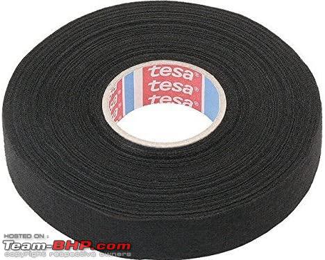

Hi, I need your advice.
Recently I have replaced the stock front speakers & tweeters in my Golf Mk7 with Gladen M Line system. It comes with a crossover for the tweeter (see pictures).
The crossover is enclosed in a thicker plastic transparent sheet housing from the factory and both ends were cables coming in and going out are open.
While installing it, I wrapped the plastic sheet housing with Tesa Fleece Fabric Tape so that it would not rattle inside A pillar where it is tucked in. When wrapping I also wrapped the openings on both ends without thinking about heat dissipation. Now I am concerned whether the wrapping would block the heat dissipation and damage the crossover.
In general whether the crossover for tweeter would get hot when active and if so why it was housed inside a thick plastic sheet instead of a proper plastic housing?
