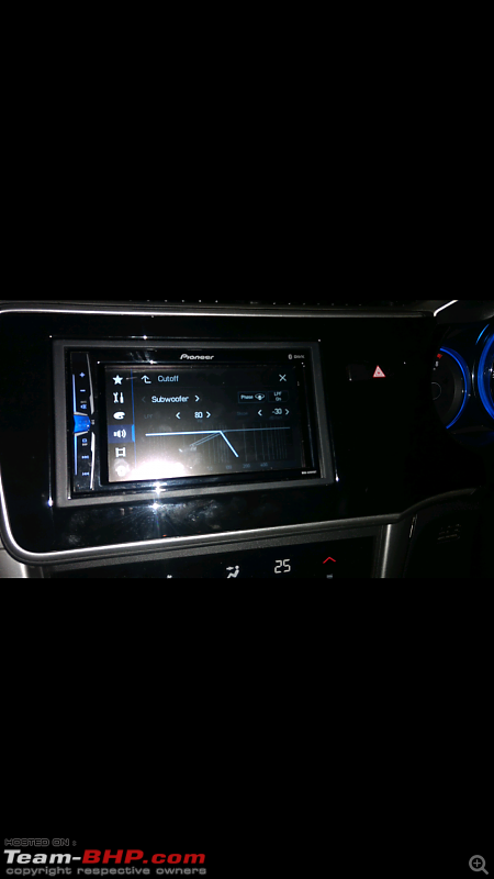

Navinji, please see below settings on HU-
Front - HPF 80 Hz, -12 db
Rear - HPF 100Hz, -12 db
Sub - LPF 80 Hz, -30 Hz.
On Amp, same HPF and LPF settings for front speakers and sub. Slopes, I don't know.
For current phase setting of sub please see below image. According to me this setting sounds better to my ears. Do you want me to reverse this setting?
Queries in 'Ask the gurus' section-screenshot_20180512201141.png.
Also I had a word with installer. Next week when I visit him, I can try different sized boxes per your suggestion.
Also I am finalising blaupunkt GTA 1500D monoblock. Readily available and getting good discount too. Should I go ahead with it?
Alfa_Romeo1 is offline

Thanked: 8,933 Times
Re: Queries in 'Ask the gurus' section
There is no slope given for the Subwoofer? I prefer a steep slope (-18db/oct or -24db/oct) for the subwoofer as it then does not interfere as much with the overall sound.
Please also consider the Kenwood mono-block (I think it is called the 917D) along with the Blaupunkt.
navin is offline   (1) Thanks
