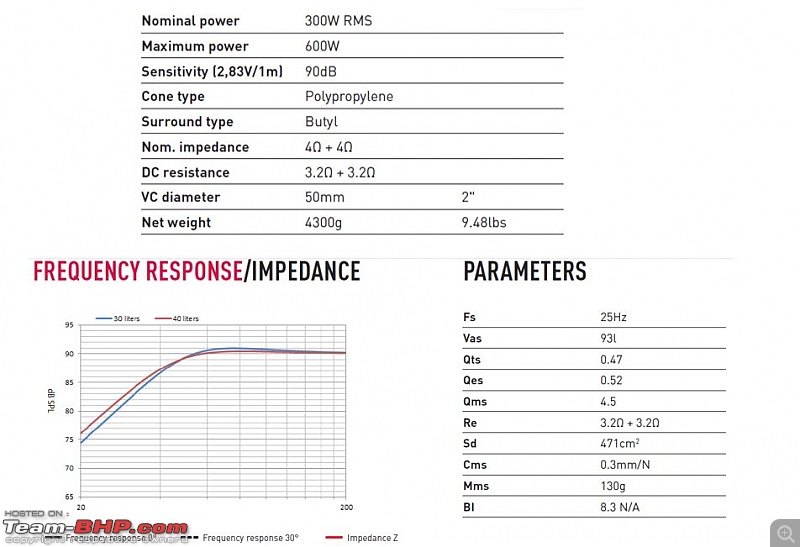

Please also consider the Kenwood mono-block (I think it is called the 917D) along with the Blaupunkt.
OK I will change the slope.
Regarding amp that you are refering, it is Kenwood KAC-PS917D, it is rated at 500 Watt RMS @ 4 ohms and 1000 watt @ 2 ohms.
http://www.kenwood.com/india/car/spe...plifier/pm_ps/
Whereas my sub is 4 ohm DVC, 300 Watt RMS and 600 Watt peak. Still should I go ahead with this kenwood amp? Please forgive me, I am a newbie when it comes to ICE, no technical knowledge.
Refer below image for detailed specifications of my sub:

Re: Queries in 'Ask the gurus' section
Yeah don't worry. The subwoofer will draw as much as it needs.
