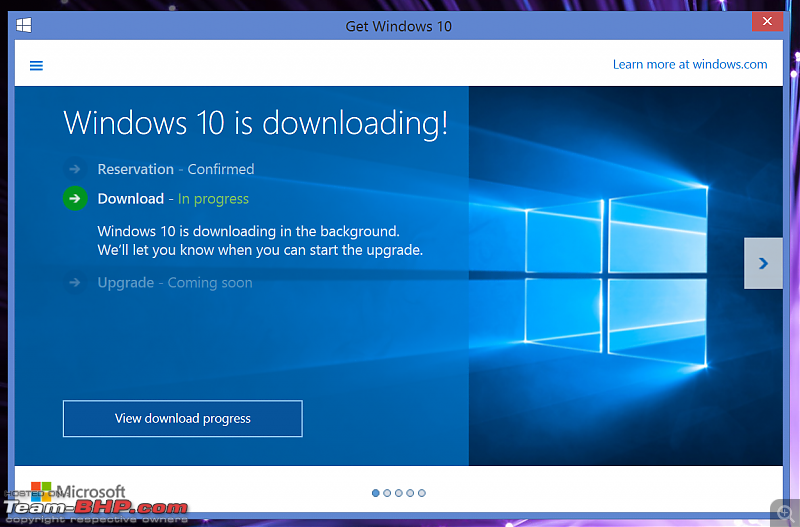

For those wondering if the download is happening in the background, you can click on the get windows 10 icon in the notification area. You will get a screen like this if the download is going on and you can also view the progress.
