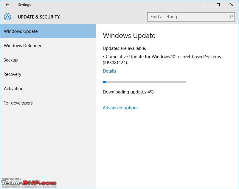

Receiving first update since Windows 10 upgrade. KB3081424
Cheers!
