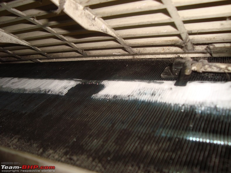

Your AC is exhibiting classical case of gas leakage. So call up the person who filled the gas and check it. If the connector was leaking how was the leak stopped? I had similar problem in my Esteem, and ultimately after a few gas fillings, changed the connector which solved the problem.
If you can, take the filter out and see if there is any ice formation on one side of the coil, that is a sure sign of low gas.
Yes there is little ice formation - it's looking exactly like when there was same problem in April this year http://www.team-bhp.com/forum/gadget...ml#post2743435.
The service guy applied some tape before tightening the connector (Don't remember the name of the tape but definitely not the PVC Tape)
Called the A/C guy this evening and he confirmed that system is running on low gas so he will top up tomorrow morning after checking for leaks. He used teflon tape on the connectors last time to prevent leakage.
