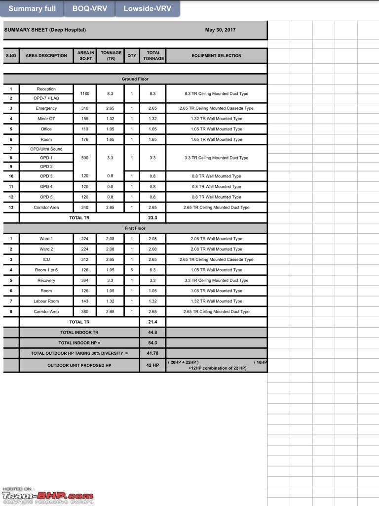

Which home/office AC (air conditioner) to buy ?
Could you share the model numbers and costs. 48HP is around 10T, and I am looking for 8T-10T solution.
The model number is Diakin VRV 4. It uses R410A refrigerant. The cost is approximately 50k per hp excluding the ventilation and central control panel.
There is some discrepancy in the conversion units. According to these guys 1.2 hp equals 1 ton of refrigeration. As the tonnage required for my setup was 54.3Tr it comes out to 45 hp. Attaching the details of equipment installed.
I might be wrong at some conversion of units as I am not an engineer, although I tried to understand all of this as best as I could.
The home / office air-conditioner thread-imageuploadedbyteambhp1496564412.775685.jpg
