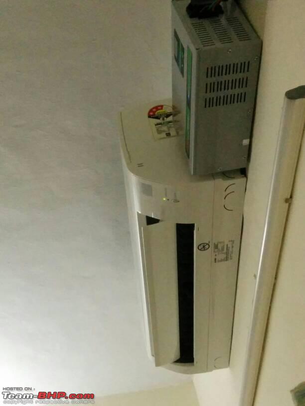

Hello Thad, some pics to help you with. First three are of mine and the rest are 2 ton machine at my sister's place. See the difference in size. Also the volume of air is very high in the 2 ton compared to mine. So reach is long.
Hope it helps.
