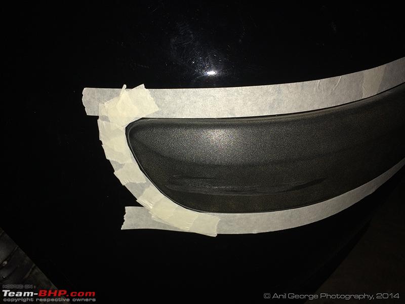

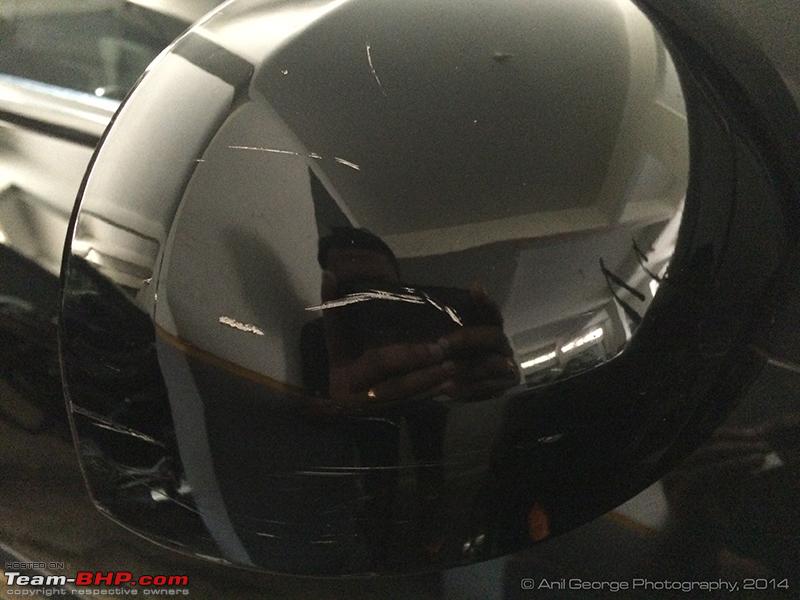

had some time on hand (read whole day) three weekends back so decided to finally take the plunge with Plasti-Dip (hey, if didn't work one can always pull it right out, right).
i had acquired Plasti-Dip from Cosmotech, Mumbai (thanks to Pankaj) couple of weeks earlier - 2 cans of matte black and 2 cans of clear coat (will tell you about that one later). my first candidate was the ORVMs on my car. why you ask? coz one too many bikers rubbed against it and there are a lot of scratches on them, like so:
since there are a couple of deep gashes, one takes a piece of fine sandpaper and rub it gently till the surface is smooth like a baby's bottom (alright, i copied that from Mind Your Language), like so:

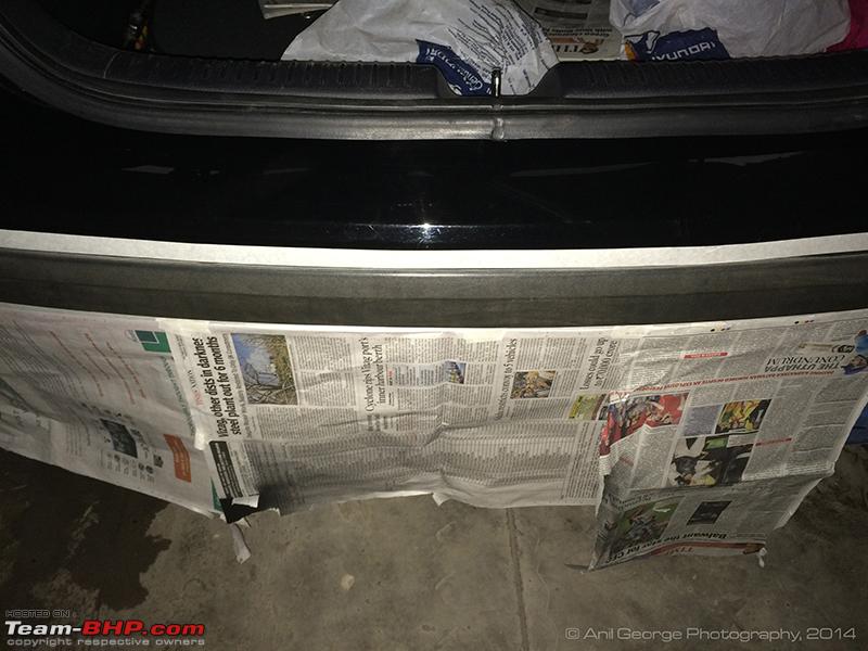

then start the cover up a.k.a masking. this was the most time consuming and tedious task; took more than an hour.
this will be a bit tricky depending on the surface you're going to Plasti-Dip. in my case, i had the small mirror in the corner, which had to be covered completely before dipping. it was a blessing that the Getz's mirror goes both ways else the masking process would have been even more difficult (read - pain in the you know where).
i know, i know, i went overboard with the masking; being my first time and all, didn't want over-spray and cause more work for myself.

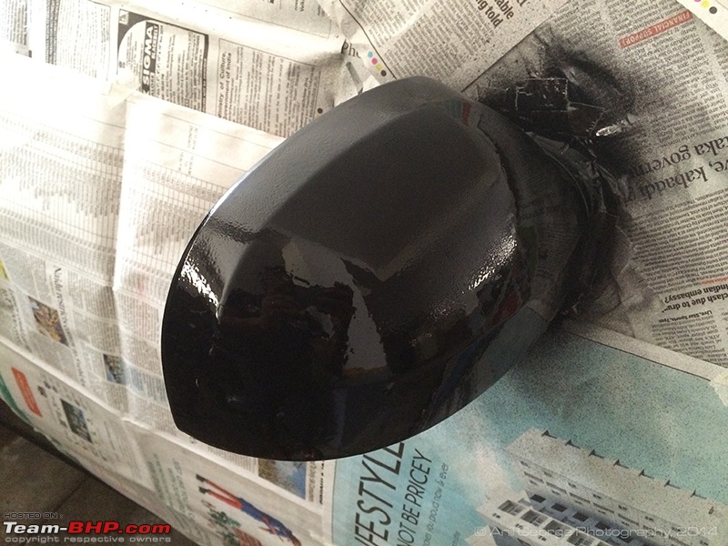

once everything covered up, nice and cozy, shake that can of Plasti-Dip like there's no tomorrow!
there's a metal ball inside the can and it will feel like you're playing with the 'damroo'; don't worry, you'll get used to it. so, once you're over your embarrassment, from a distance of about 15" (the small scale length we all had in school geometry box) spray from side to side on the ORVM in a controlled and even fashion.

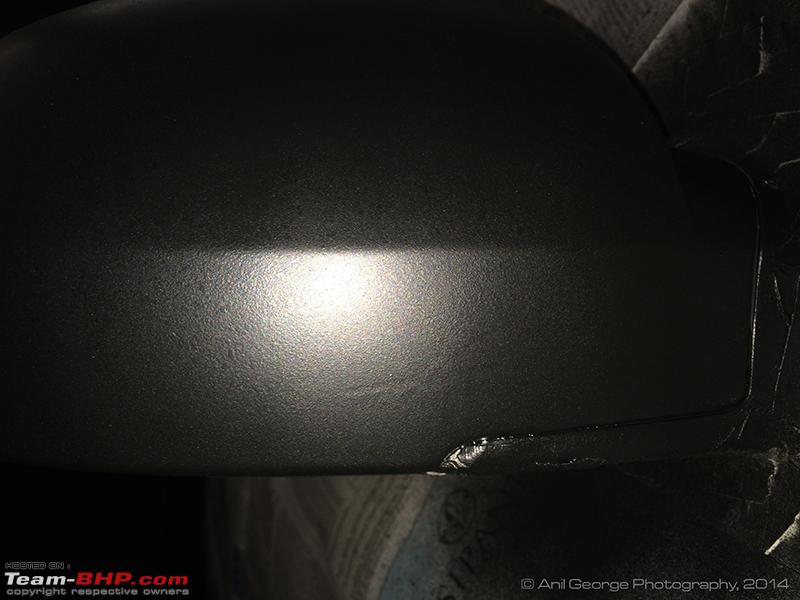

after spraying the first coat, it will look like this:
don't panic. within minutes it will look like this:
improves with every coat:
one has to wait between coats, like say 30mins. i know, once you spray it dries within minutes, but i would advise to give it a good half hour to set properly before applying the next coat - i've applied 5 coats just to be sure.
you can see the difference already showing in the two mirrors:
