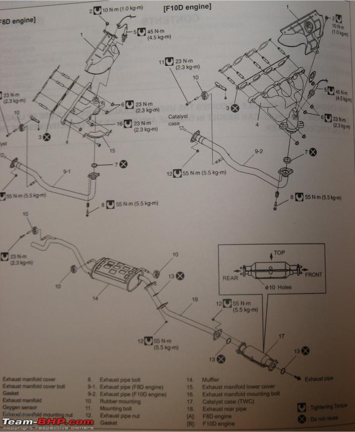

Originally Posted by badboyscad View Post
I see two mufflers in the alto. Does the one, circled in red needs to be removed in order to fit an aftermarket muffler ?
The first one near the shifter is the cat, the one you've circled is the muffler. Hope the following pic helps.
If you go with a custom end-can, they will not have the 'kink' in the tail-pipe to clear the rear axle (Remus however makes an end-can for the Wagon-R that allows this). Otherwise, your best bet would be to get a custom end-can & install it differently - for example, like this.

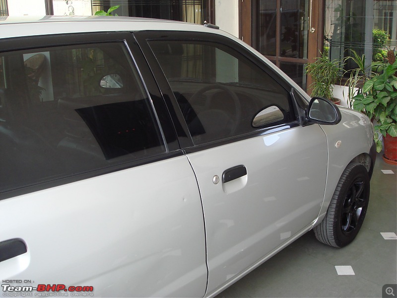

its been long sicne i dint do anything on my alto, so i decided to get my door frames painte to solid black like any other lancer, corolla, cedia etc etc.
here are the pics.
this looks more wicked in the evening as the tints looks more darker

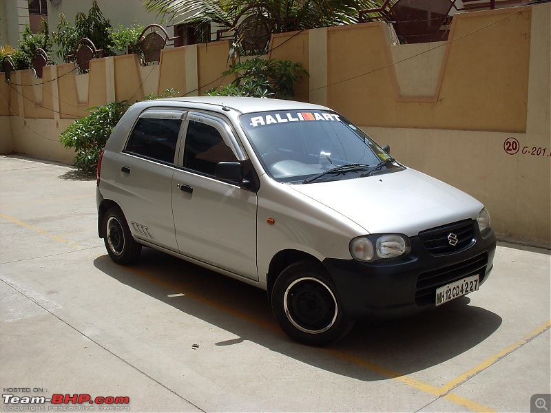

here is a bit on my alto. though i dont have alloys, i just took an innovative idea of better wheels from a zen here on the forum. i tried hard searching the chrome trims in pune, but couldnt find one. finally i requested our forum member ImranShahnawaz from bangalore to buy them for me there and courier it to me.
i am very thankful to him for his efforts to find a rare set of 12" chrome trims for me. i painted my rims matte black and then put these trims.
