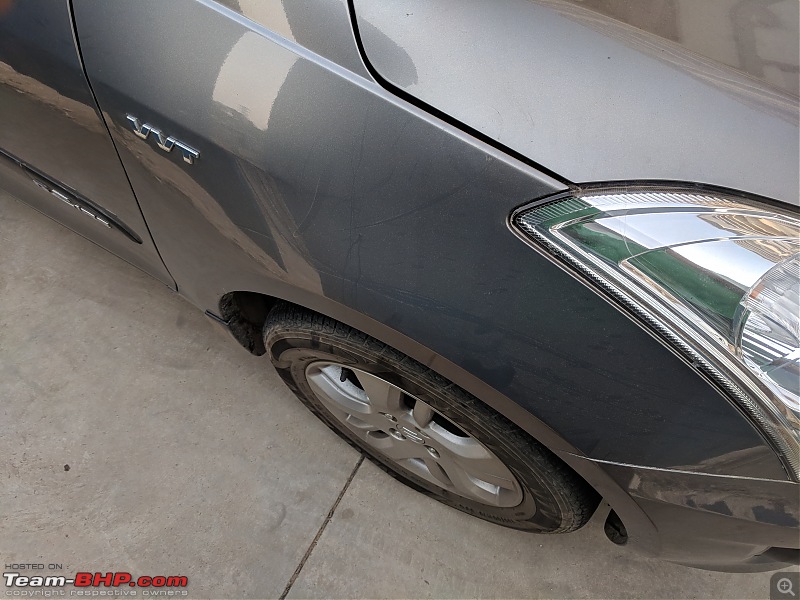

Its been almost 26 days since my last car wash and thought I can blow off some steam by cleaning it after office hours today.
Thought 476s will be the worthy foe of choice for today and started regular wash and wax cycle.
Learnt an amazing lesson.
Temperature here in Hyd is hovering at 40 C and about 35 in shade. And I started with a bucket of water from my bathroom with oodles of soap liquid. The first bucket wash did nothing, but the second bucket is what caught me off guard.
I filled it from garden tap in my apartment and it was uncomfortably warm. This I did not notice and was concentrating on removing the suds off the body. It raised the temperature of car body significantly and it caught me unaware.
I dipped the foam applicator in same water and swirled 476s from tub. Very very wrong move.
Due to poor lighting, I did not see that the already buttery soft wax was now like Mayonaisse (due to warm foam) and when it touched the car surface, it easily spread. I congratulated myself for finding myself a worthy activity during lull periods of office work and finished entire application in under 15 minutes.
While I was talking to a colleague over the phone, strong gusts of evening wind reduced the temperature in my cellar parking significantly that the wax now coalesced on the surface. Since lighting was not that good, I did not observe that the wax was actually eating away the foam pad as I applied.
It then dawned on me that I made the biggest mistake of not observing properly. Took me a solid 60 minutes to rub every nook and corner of the car surface and severe dehydration followed.
This pic summarizes today's battle.

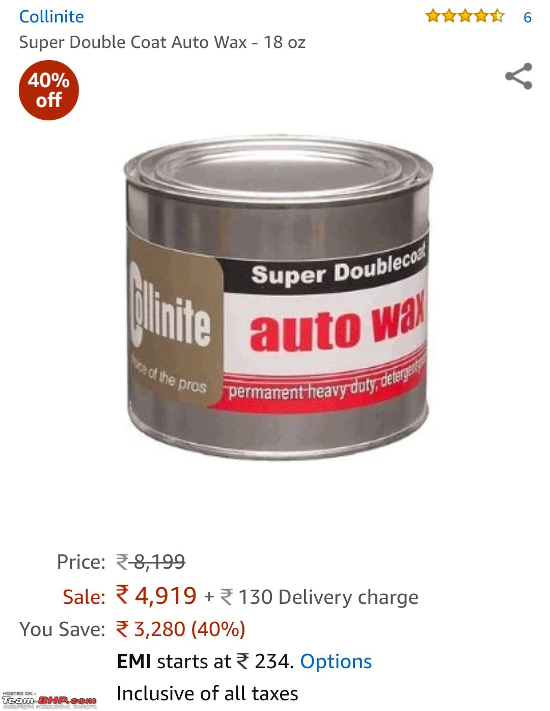

Are you guys even looking in Amazon for the range of Collinite products that are being sold at amazing discounted price ?
18 oz tubs now available for 885 & Double coat. Those with extra few bucks in their pocket this month, don't miss.

This is Amazon US or India? I couldn't see anything on the India site. I'm probably missing something.
Check through Amazon app R2D2-san. Import fulfilled by Amazon themselves. Just search Collinite in app. You will get these.
