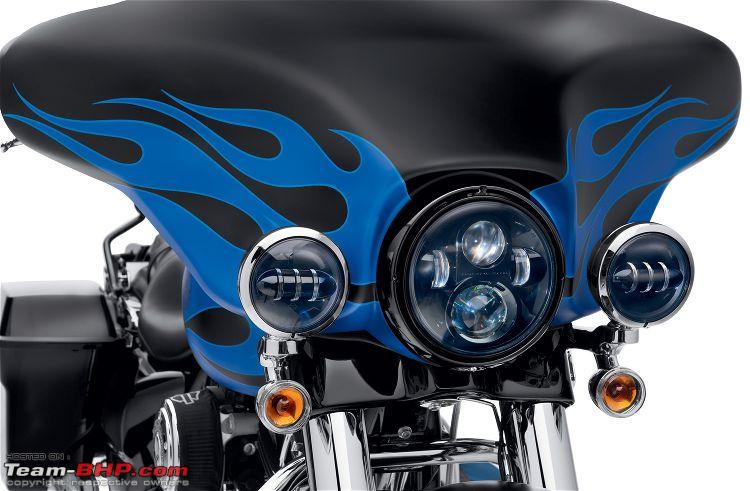

Just came across this video on Harley Davidson bikes, they have introduced optional LED head lamp system on their bikes.
Auto Lighting thread : Post all queries about automobile lighting here-1103_crup_01_oharley_davidson_black_led_headlamp_auxiliary.jpg
Here's the video on stock HL Vs LED HL
Cost is also very tempting, only $399.95 only
LED Headlamp and Auxiliary Lamps | Genuine Motor Accessories | Harley-Davidson USA

If the beam shots in the video are for real then this is an awesome piece of kit. LEDs consume much less power than HIDs, have a lifetime of 50000-100000 hours and don't need time to warmup. They're also much more rugged than HIDs. Forget Harleys, we can fix these on our Bullets! Not to mention any vehicle with a round headlamp. Gypsy owners rejoice!
