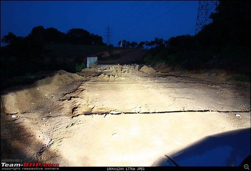

Originally Posted by Tassem View Post
Could someone please post a photo showing the beam pattern when the HID kit is installed within a stock reflector unit?
I dont have the pic showing the beam pattern on a wall. Here's one taken in an open ground.
Car - Swift
HIDs - Philips 6000k running on stock reflectors.
Low Beam
Auto Lighting thread : Post all queries about automobile lighting here-6000k-low.jpg
High Beam
Auto Lighting thread : Post all queries about automobile lighting here-6000k-high.jpg

Old 26th July 2011, 10:57   #5334
sohail99's Avatar
Join Date: May 2009
Posts: 1,270
Thanked: 210 Times
Default Re: Auto Lighting thread : Post all queries about automobile lighting here
Wow!! Those are BRIGHT!! Kinda overbright for the camera lol!
How does it look in person. In the pic it looks like 6000k kinda hid some features of the ground unlike 4300k!
btw got my indicator LEDs and I was really disappointed to find out that the blinking speed has increased quite a lot with LEDs!!!
Currently, I'm looking for alternate 'flasher(Hazard) relay' options! Any other suggestions will be welcome!(I not looking to add resistors as then, they'd kill the whole point of LEDs(Low power consumption, very low heat etc.)
sohail99 is offline

4300k HIDs with projectors - High inside view
Auto Lighting thread : Post all queries about automobile lighting here-high-.jpg
4300k HIDs with projectors - High outside view
Auto Lighting thread : Post all queries about automobile lighting here-high.jpg
