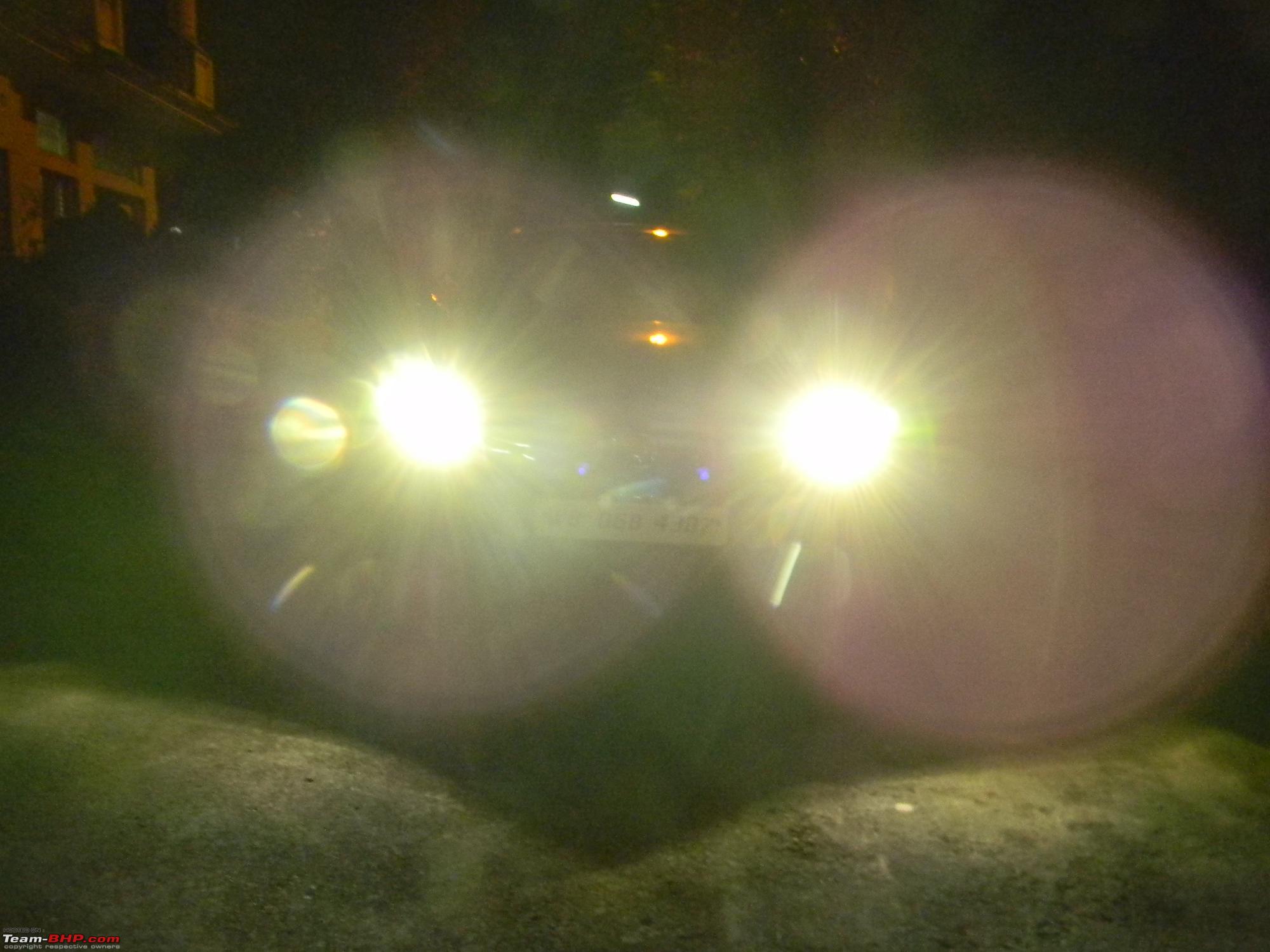

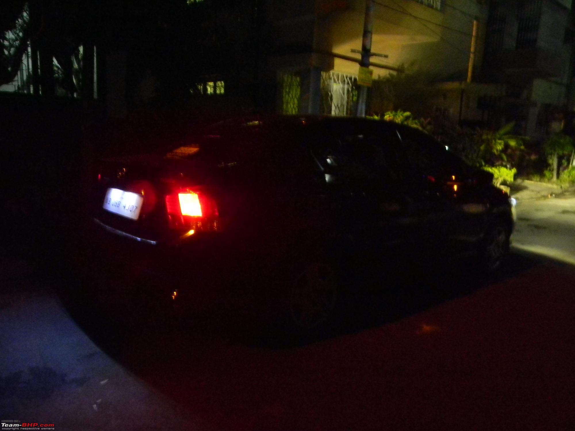

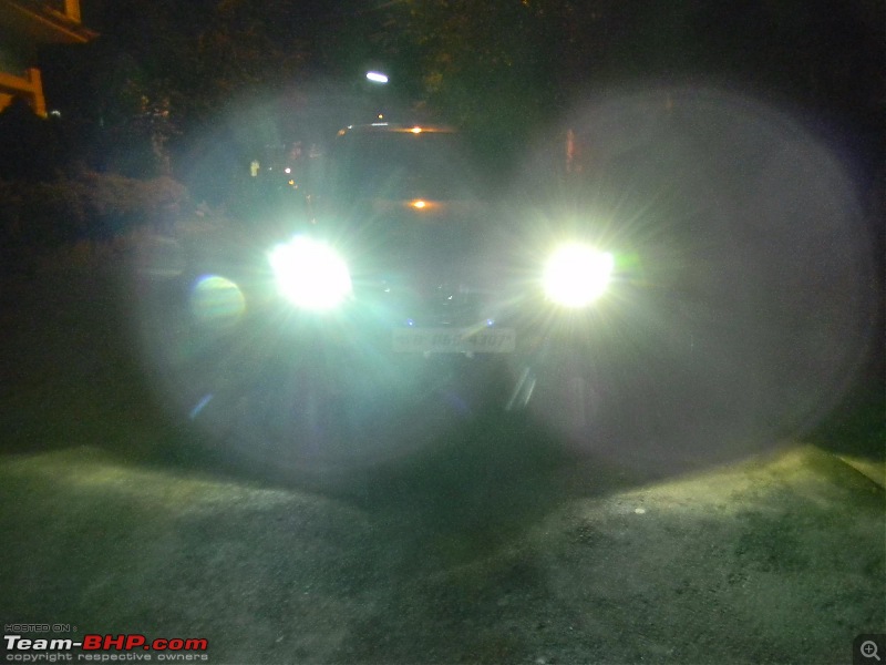

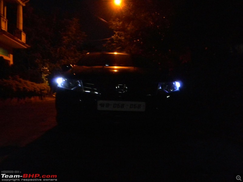

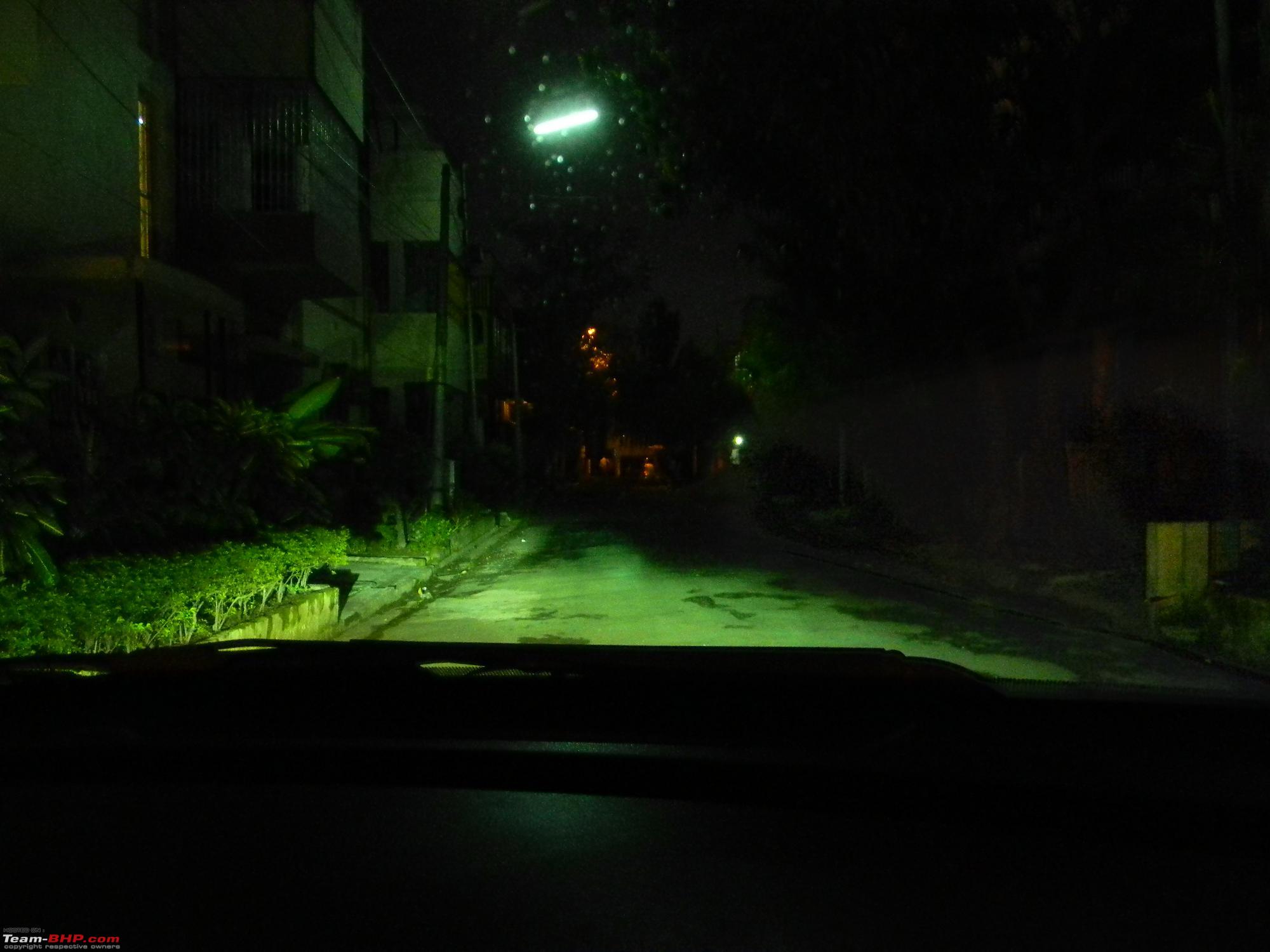

Sorry for the Delay guys.Lazy me.
Parking Lights Exterior
Auto Lighting thread : Post all queries about automobile lighting here-dscn3452.jpg
Low Beam Exterior
Auto Lighting thread : Post all queries about automobile lighting here-dscn3453.jpg
High Beam Exterior
Auto Lighting thread : Post all queries about automobile lighting here-dscn3455.jpg
Low Beam Interior
Auto Lighting thread : Post all queries about automobile lighting here-dscn3458.jpg
High Beam Interior
Auto Lighting thread : Post all queries about automobile lighting here-dscn3459.jpg
Random Exterior Pictures
Auto Lighting thread : Post all queries about automobile lighting here-dscn3460.jpg
Auto Lighting thread : Post all queries about automobile lighting here-dscn3461.jpg
cityvic is offline
Old 18th July 2011, 13:39   #5310
naveen.raju's Avatar
Location: Cochin
Posts: 4,913
Thanked: 9,545 Times
Thanks for the pics. Looks good. Is it aligned properly? Think the driver side beam isnt spread well compared to the left side. Might be due to the pics.
