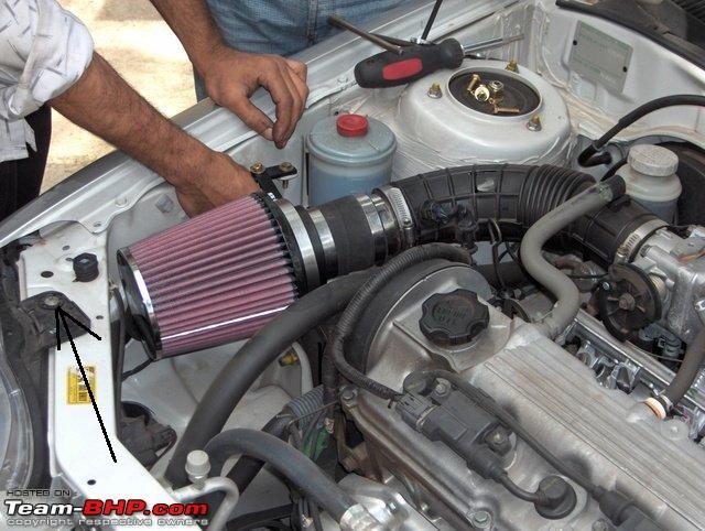

Originally Posted by Guite View Post
I never knew about headlight focussing. Do wheel alignment shops usually do it or company workshops also? Does it need specialised equipments? Can I have it selectively focussed on those people who insist on driving with high beam on in city streets? Hehehe... just joking on preceeding sentence.
guite almost every other car has this feature. Open the hood and you should be able to see a screw holding the assembly to the chassis frame. See pic below for illustration, you cant get much of play though, hardly a few mm.
Auto Lighting thread : Post all queries about automobile lighting here-kn.jpg
Thanks for the photo illustration. I have been doing that myself. What I had thought was that "focusing" in this instance meant changing the beam spread (wide / narrow) and shape. This is of a particular interest to me right now because, in low beam, both head light in my car tilts up on LHS and cutoff (light to dark) is not sharp.
