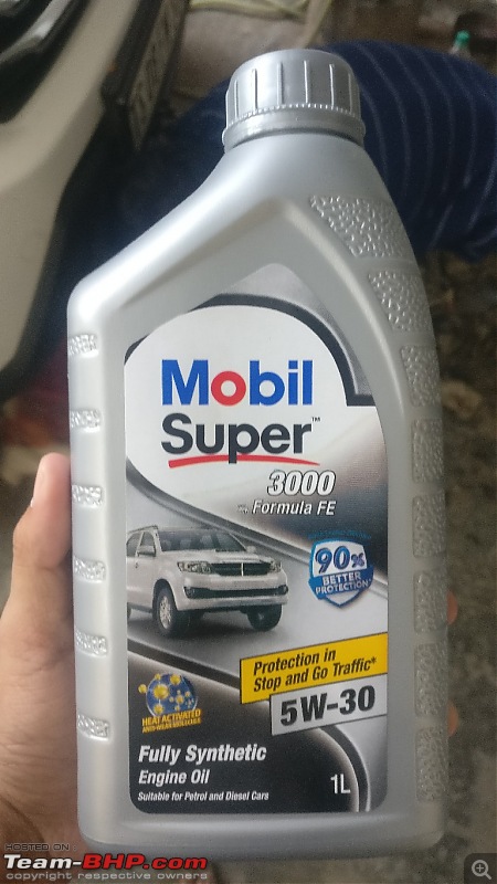

I have used this oil in my Creta (1.6L CRDi) during the 70,000kms service. The distributor didn't have the 3.5L pack size so bought 5 cans of 1L.
ARTICLE: Synthetic oil vs Mineral oil-img_20191223_163312_copy_768x1365.jpg
ARTICLE: Synthetic oil vs Mineral oil-img_20191223_163317_copy_768x1365.jpg
Shall be getting the same oil again for the 80,000 kms service that I'll be doing in a few days.
Hyundais post 2018 need 5w30 a3b4 and shell helix hx8 5w30 or shell helix taxi 5w30 are the only ones that fit the bill. The Mobil is a5b5.
Don’t worry about the taxi tag, it only means extra detergents added for high mileage mostly city use, quite a good oil that I recently filled in my wife’s i10.
