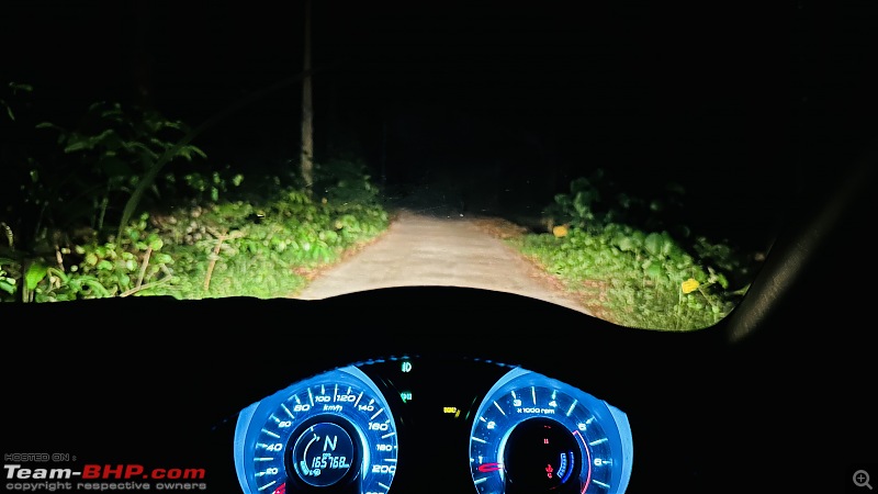

Driving a rental W10 AT FWD and this popped up while accelerating hard. Everything seems absolutely normal (same car had a blown coolant pipe last year and faulty central locking in 2022) and rental guy said it's okay. Engine! light is on. Should I be worried? I will keep it till monday.
