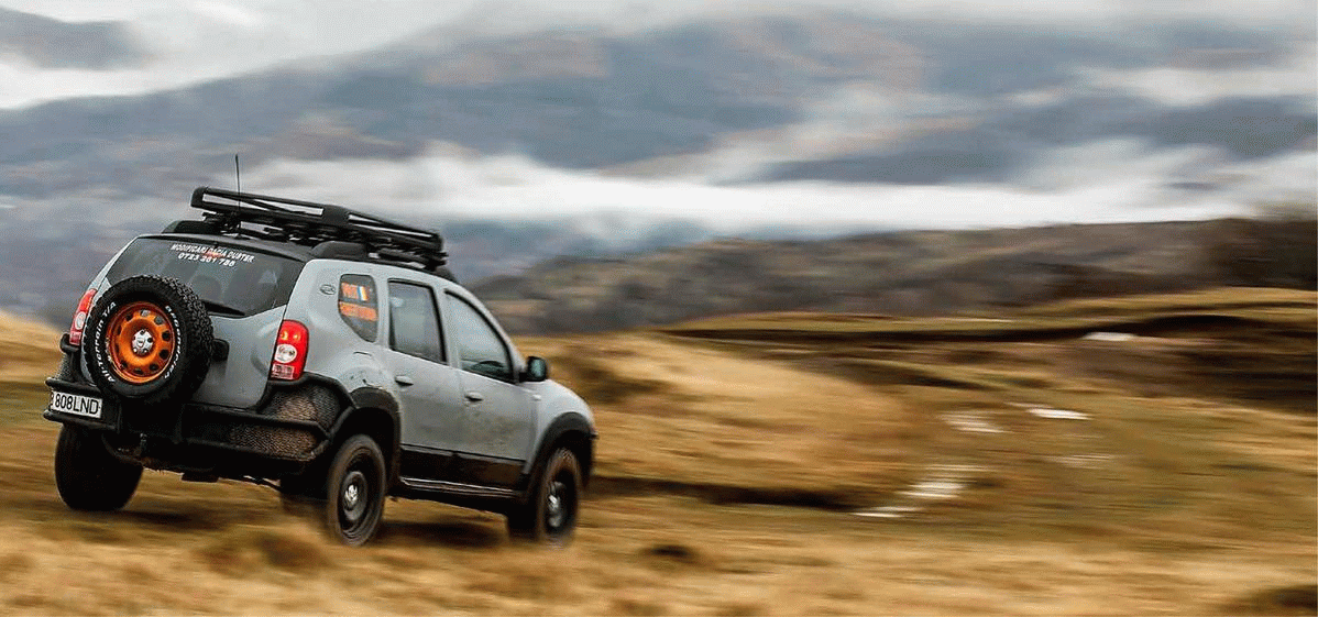

Thanks to Charanjeet Singh for sending this image in. Heartfelt gratitude for sharing it with other enthusiasts via this Team-BHP page!
If this Duster owner has any sense, that's just an empty cover for show and the actual spare wheel is in the original place. Else, it'll be too much of a load for the poor tail-gate. That said, it definitely has potential if executed well:

The Mudster does it well. However I think its attached to the modified rear bumper which slides outwards.
