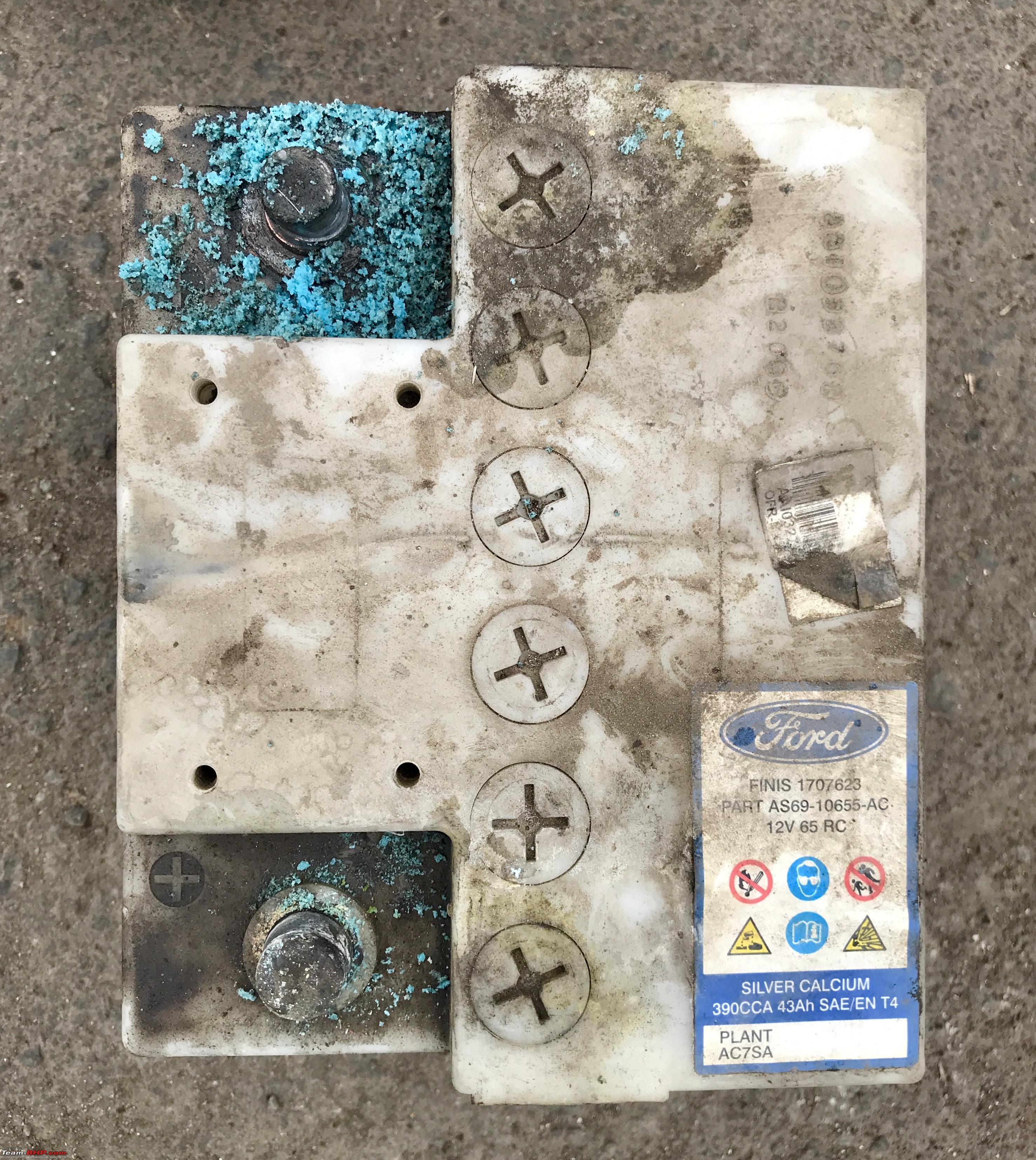

The stock battery which i was using for 4 years 63K km was finally showing its age. Crank times were long, MID used to give mysterious errors like ABS malfunction and so on (Why they just cant give low battery warning ?) Finally one day it refused to start when i was out and had to jump start the car. That was the ultimatum and i finally decided to get a new battery.
I had two options: Get the Ford OEM one or Aftermarket. Ford was giving discounts on batteries as a part of their monsoon camp. The 43AH stock one was quoted as little as 3.8K. However i wanted to go for a better option as this is something i change in few years. Amaron FLO seem to be the choice for most people here so i headed to the nearest Amaron Pitstop center to get my battery replaced. The 55AH was quoted as 5k & 65 one as 5.5K with 5 year warranty & existing battery replacement. I wanted the 65AH but to my dismay i noticed it cannot be fitted in the compartment. I wonder how other people have fitted the 65AH one.
The battery compartment by default takes 43AH one. There is a plastic raiser which can be removed to make room for the 55Ah one. But in no way it can accommodate the 65 one without modification. So i opted for 55 one and everything was done within 10 mins.

Old OEM Battery
