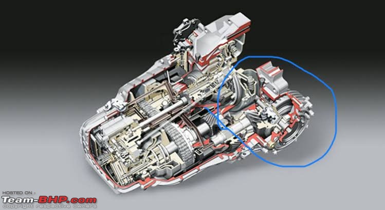

I'm guessing which is why they can't use the same DQ gearboxes as well since the A4 is a weird longitudinal engine mount with a front wheel drive.
Yes.
Isn't that counter intuitive actually to have longitudinal mount but exclusive front wheel drive.
It does sound counter intuitive and should normally lead to more transmission losses. But the layout of A4 transmission is Engine -> Flywheel -> Drive shaft to the wheels -> Gear box.
This position of the driveshaft allows direct connection to the driven wheels - if the drive shaft was behind the gearbox, as is normally the case, it would have led to a convoluted final drive layout.
Drive shaft circled in blue located at the front of the gearbox:
