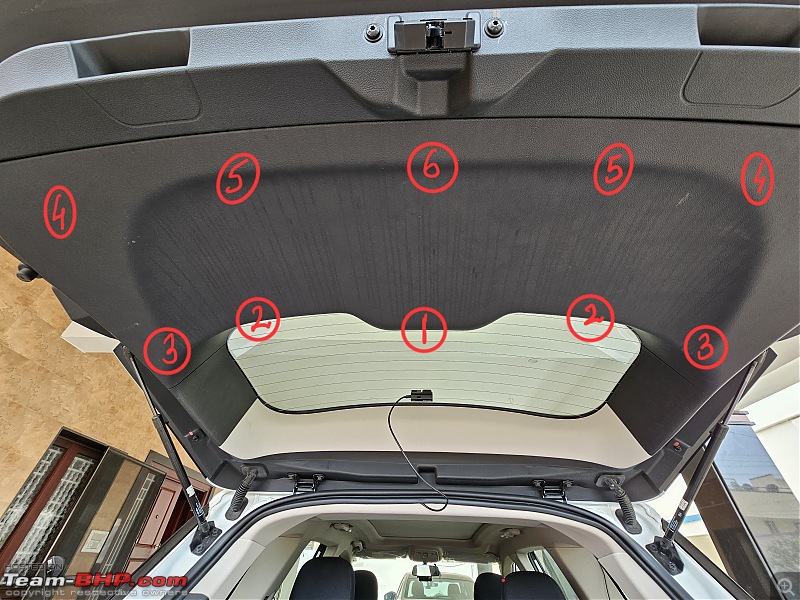

1) Start by removing the small tail panel on both sides. Pull the panel down and it should come off easily.
2) Locate this screw behind the panel and unscrew it. This screw holds the larger tail panel in place.
3) After doing the above steps on both sides, you can now proceed with removing the larger tail panel. The larger tail panel has plenty of lock tabs and I would suggest removing it in this precise order:

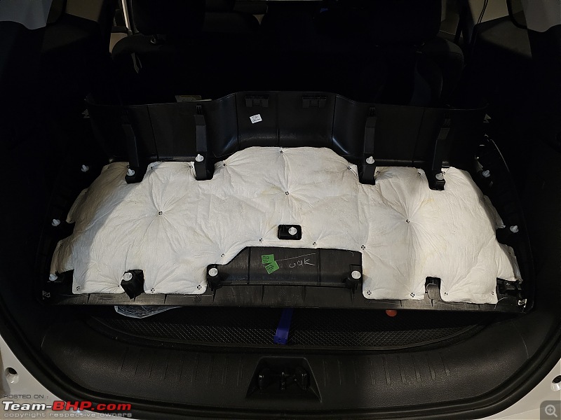

4) The tail panel removed and carefully kept aside.
