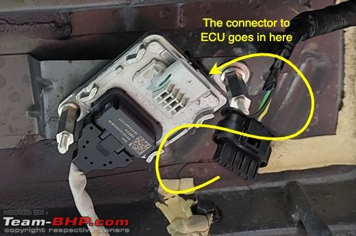

I am seriously suspecting the NOX sensor and water ingress story from ASC.
Thanks for your inputs. It gives me some confidence now.
I don't believe the water ingress is causing the issue either. The wirings must be sealed well. Mahindra engineers wont be careless enough to cause continuous recalls due to a wrong design of NOX sensor placement under the body. They must have thought of it. But the way the setup is done under the body is also something to ponder. The opening of the enclosure of NOX is forward facing. This is done for the air movement for sure because the fins on the sensor are also in that direction. But then this setup will definitely scoop up water and can short the connectors unless they are sealed well.
Latest update I received from the ASC, they identified a grounding issue and the black wire is not conducting the way it should. Hopefully they found the problem and know what to do.

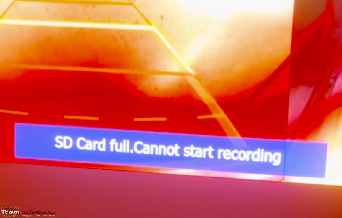

Getting strange error in XUV 700 ax7L after more than 1.5 years of ownership. I had a dealer installed DVR SD card and never observed this SD Card full issue.
My understanding was that the DVR keeps on overwriting on older files once the memory runs out.
The message pops up when the car is put in reverse. Have tried to find out how to format the card but I don’t see any option in settings. Can anyone help, I am worried to drive without a dashcam/DVR. Having said that, I also don’t know how to access the DVR videos
Have you retrieved videos recorded on DVR SD Card anytime? The video recordings are from the 360 degree camera. This means the powerful fish eye lenses are designed to capture a very wide angle. The 360 view software stitches together these videos to give a surround experience. This image below is from the XUV700 user manual
https://storagewyh.blob.core.windows...rs-Manual.html
These videos are good for detecting objects around but may not be useful for general purpose or even to detect a number plate. Still it is a good to have for emergency situations. Best to have a good dashcam installed.
I couldn't find any mention on how to format the SD card in the manual, I believe you will need to physically access it and format using a laptop or phone.
Go for an Endurance microSD rated at least class 10 for FullHD recording (30MB/s write is recommended for 4K video recording). Endurance because of the continuous writes. General SD are good for storage. When read is more than write.
The system has a tendency to move videos to emergency folder even if it detects a small jerk while reversing or even during hard braking. 1.5years is a good time to fill up the 32GB storage of SD card. I did face this issue in my car and this is how I got rid of the error
Press the SVCS button on the dash to bring up the video feed. A touch on the top right screen will bring up SVCS menu. Click on settings clog wheel --> Drive video recording--> Emergency videos... select all and delete.
